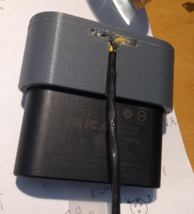

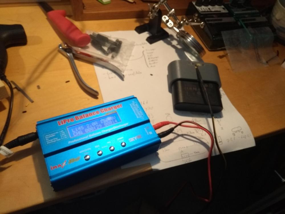

Yes, the Imax B6 charges with the cup, but no balance charging. The battery has four pins which according to some teardown images seem to be plus, temperature resistance, ID resistance and minus, so no access to the individual cells. I suspect the batteries have some sort of BMS, but not sure what kind. I tested charging 500 mA with my Imax at constant two amps for fifteen minutes and the charging voltage varied about one volt above the battery charge.
Ikea made a bluetooth speaker for which you can buy a 14.4V, 37Wh battery, costing about $20. I made a 3d-printed holder for it so it can be used to power a sound bag and other equipment. These packs can be charged in the speaker (the smaller model) itself or with smart chargers like the Imax B6. I've mentioned these batteries in Allen Rowand's DIY BDS topic, and being inspired by his contributions to the location sound DIY community I wanted to add to it as well. Speaker https://m2.ikea.com/us/en/p/eneby-bluetooth-speaker-white-40401393/ Battery https://m2.ikea.com/us/en/p/eneby-battery-pack-20414264/ Thingiverse link https://www.thingiverse.com/thing:3681131
Using the speaker to charge it seems like a good start, but then it would be fun to try and create a separate charger, maybe even a dual bank charger. Nice, also very good value for the Talentcell. Inspired Energy is pretty neat with monitoring battery usage and approximate remaining time, it's a good upgrade but costs a bit more of course.
