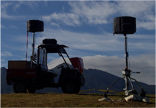

Jeff Wexler Posted October 24, 2012 Report Posted October 24, 2012 I'm with Bud (and his father) on this, preferring to use passive speakers instead of active (powered amp within the speaker). That said, I have used for many, many years, the amazing BOSE Acoustimass powered speaker for most all of our major PA/VOG work. I have also used Mackie powered speakers and on the very small side of things, several of the RemoteAudio SpeakEasy speakers (powered). Whenever we do playback or PA/VOG setups, I always have some rackmount gear set up on a cart and this cart could easily have a good power amp that would allow for a single speaker cable to be run. This is the way I would like to do it. If I ever put together another PA system I will use BOSE 802s (passive) and an amplifier that sits on the PA/Playback cart so I don't have to run AC to each speaker. Below you can see our BOSE Acoustimass setup on "The Last Samurai" (used almost everyday in New Zealand to talk to the well over 1000 extras in the battle scenes). Quote
Brian Liston Posted October 24, 2012 Report Posted October 24, 2012 So Jeff is that a yoke going to a head, or is it a junior pin right to the speakers? Quote
