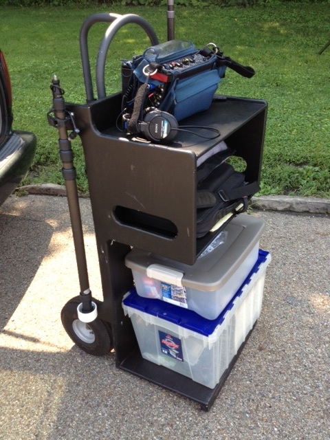

Robert Buncher Posted December 2, 2012 Report Posted December 2, 2012 A couple years ago i built a very low tech bag cart from material I had in the basement--1/2 and 3/4 inch plywood and a steel hand truck. I used the 3/4 ply for the sides and bottom shelf and the 1/2 ply for the two upper shelves. The bottom shelf has a foot at the front to keep the cart level. This cart is very stable and easily rolls over most terrain. When moving I place the bag on the middle shelf in the box like structure and it is very safe. If I actually have a boom operator I then have the option of standing and mixing from the top shelf or sitting and using the middle shelf. The cart very easily slides into the back of my small pickup truck and rests on its back. This picture was taken before I moved the boom pole holders to the inside of the frame thereby making the cart narrower and protecting the poles. Like I said, very low tech but it works for me. Bob Quote
chrisnewton Posted December 2, 2012 Report Posted December 2, 2012 nice work RB. does the box part come off the cart easily or is it designed to be permanently mounted? Quote
Robert Buncher Posted December 2, 2012 Report Posted December 2, 2012 Thanks. It stays together. It's all one piece that is bolted to the hand truck with two u-bolts except for the bottom shelf which is bolted to the bottom steel plate of the hand truck. Quote
MatthewFreedAudio Posted December 3, 2012 Report Posted December 3, 2012 RB, out of curiosity, do you ever find that cart to be top heavy or is it balanced pretty well? Quote
Robert Buncher Posted December 3, 2012 Report Posted December 3, 2012 No, not top heavy, very well balanced. The large bottom shelf with foot resists the tendency to lean forward which you normally get in this type of hand truck. I have relieved some of the weight by cutting anyway unnecessary plywood, which is not really visible in the photo. Also two of the shelves are half inch ply so there's not really much weight on top even though it looks that way. The metal base and especially the tires supply sufficent weight at the bottom. When I thought about building the cart I thought it might be too heavy because of the steel handtruck but the weight is just right, it feels very secure and handles nicely. There is some lens distortion in the photo that causes the upper section to appear larger, in relation to the rest of the cart, than it actually is. The shelf depth is 13 inches. The cart is 22 inches wide. You can see the distortion, it makes the box look out of square, but in fact, it is square(in the carpentry sense of square). Quote
