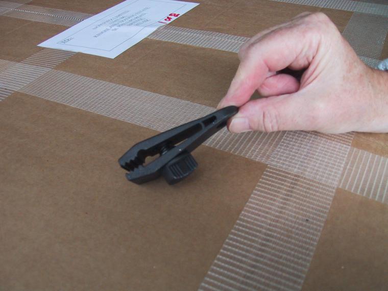

Malcolm Davies Amps CAS Posted February 24, 2013 Report Posted February 24, 2013 Here is a photo of the clips I sell with our sound blankets. Being plastic there is no chance of damage to the fabric. Quote
