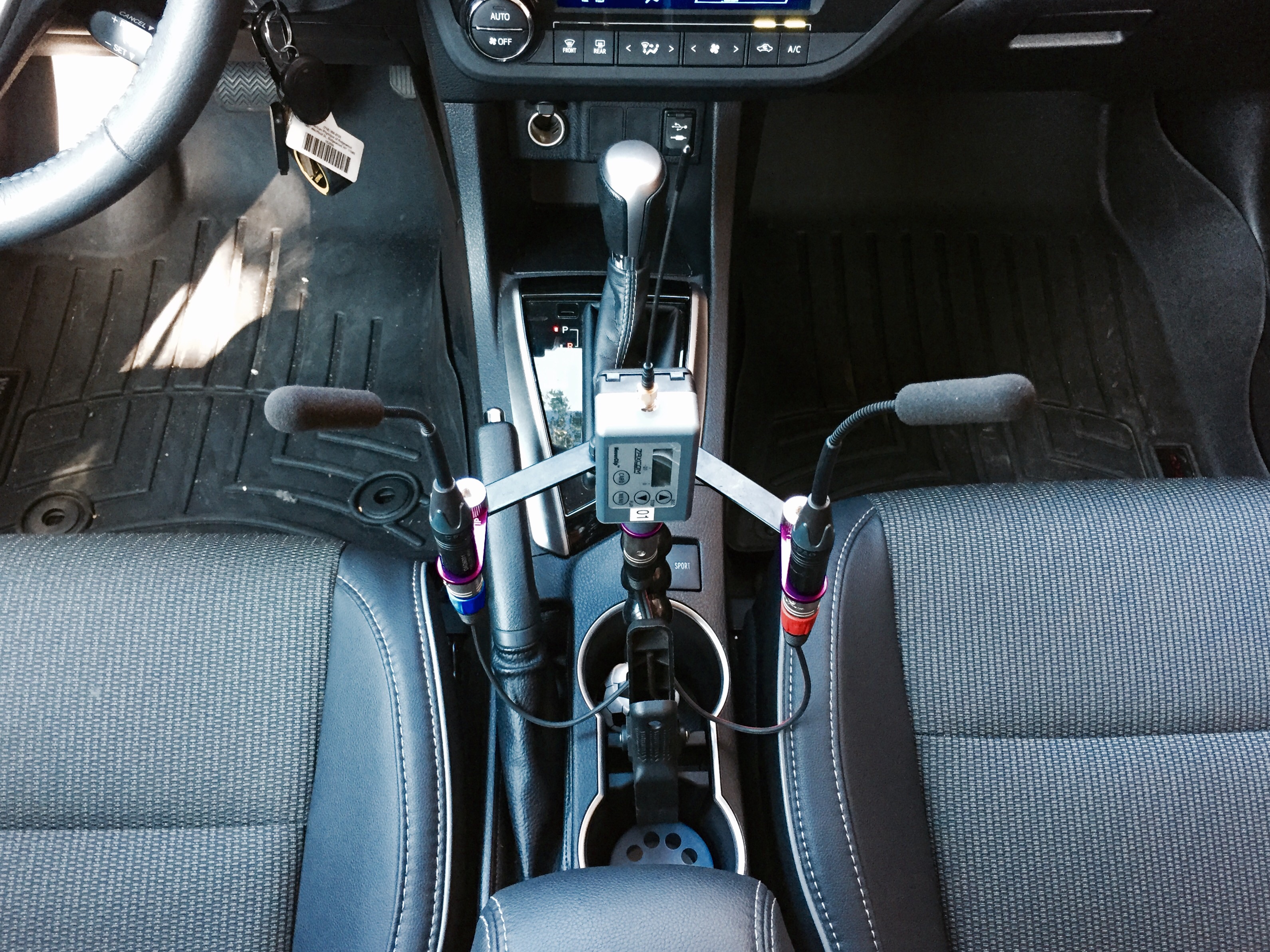

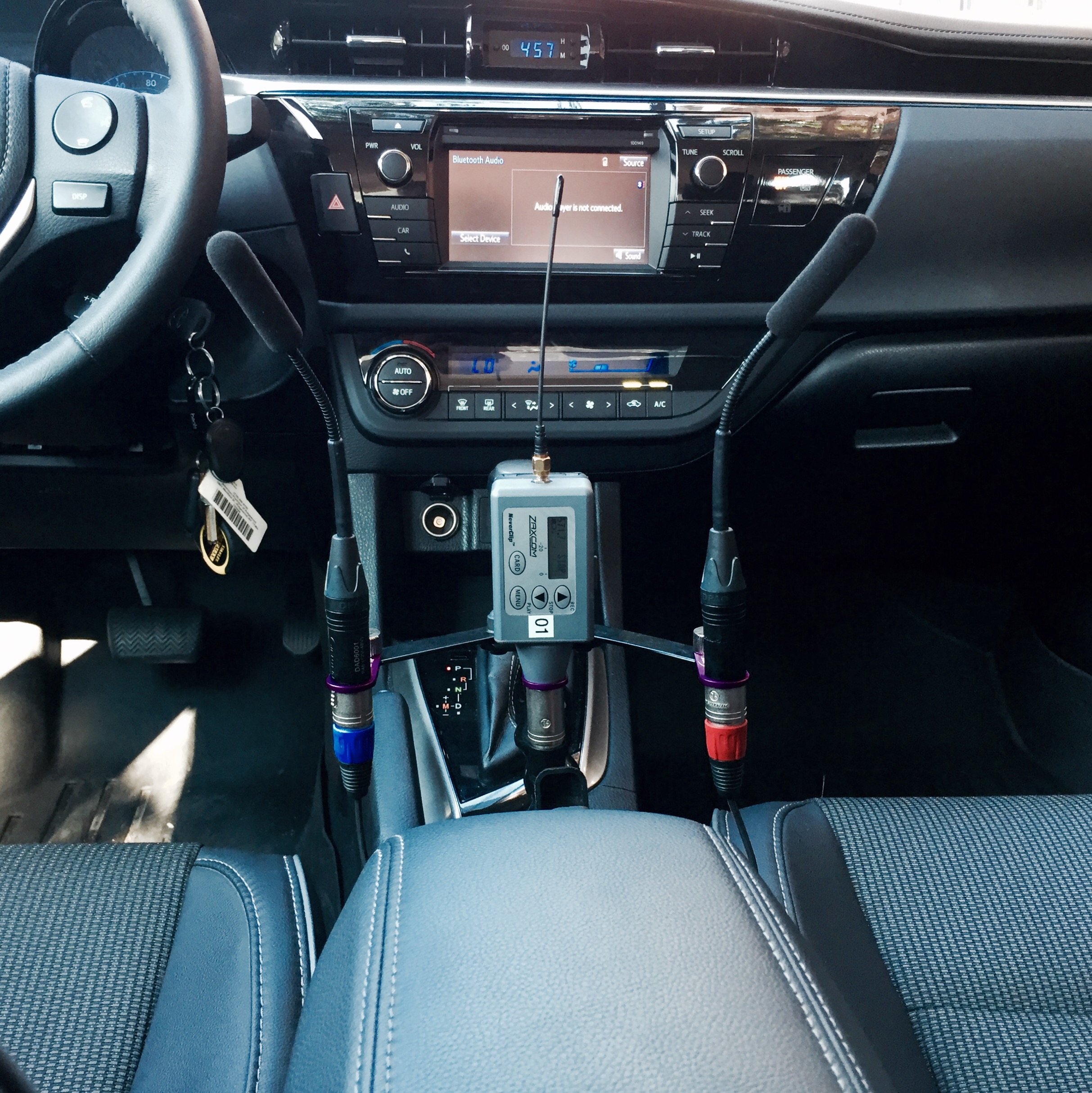

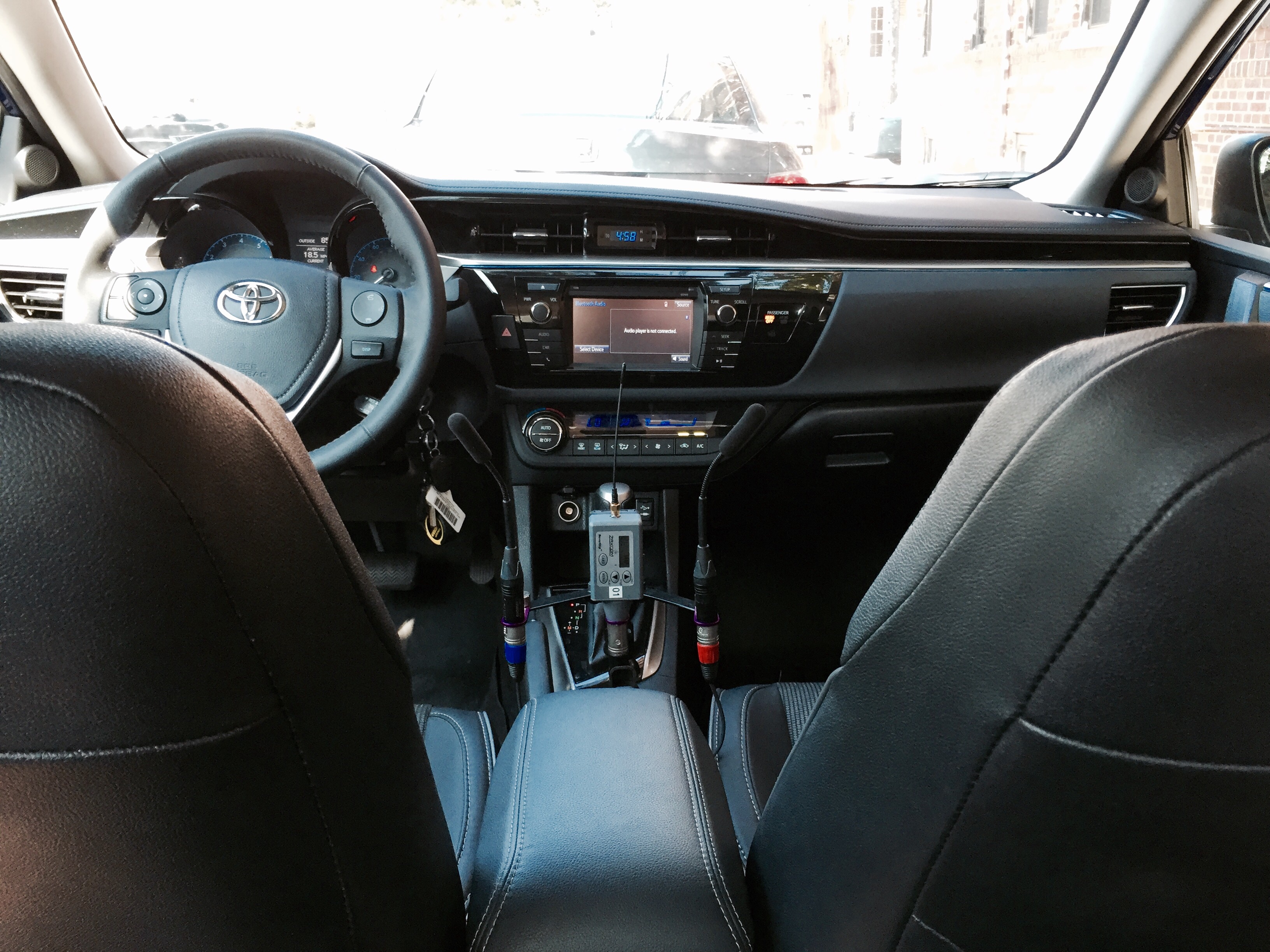

Ze Frias Posted July 11, 2015 Report Posted July 11, 2015 I've been experimenting with the DPA 4098s for car mounting, and after some tinkering, I've made this dual 4098 mic setup going into the Zaxcom TRX742 wireless plug-on transmitter. It's proven very useful for recording the driver and passenger simultaneously, and very flexible as I'm using the "stereo" cone on the TRX742, allowing me to transmit two discrete tracks within the same transmitting frequency, as well as record a two track MARF backup to the built-in MicroSD card. The mics and transmitters are rigged using a stereo mount that I've made up with pieces I had around. I'm using a dinkum arm to grip it to the cup holder divider in between the driver and passenger seats in the photos below. I'm already working on a different "upgraded" version of this that will use a heavy duty suction cup to attach the rig to the windshield, and with an actionable arm to keep it flush against the roof of the car. Then I can bend the gooseneck to the ideal mic'ing position. Quote
Matthias Richter Posted July 11, 2015 Report Posted July 11, 2015 looks good! You might wanna get a 90`antenna to keep it low profile. How is the 742 playing with the DPA in close distance? Any RFI problems? Just used my 742 with a CMC6MK41 in a car that got out of reception. That part was missing on the card?! It might have been a close Teradek transmitter on the camera that confused the 742 ... Have switched off the IFB function since then if I needed to rely on the card recording. Quote
Ze Frias Posted July 11, 2015 Author Report Posted July 11, 2015 (edited) Thanks! No RFI issues at all whatsoever. I'm very happy with this rig so far. Still experimenting with other ideas to improve on it. Regarding the missing card recording, did you have remote transport control active on the 742? I typically turn it off, and manually set the transmitter to record. Hasn't failed me yet. Edited July 11, 2015 by Jose Frias Quote

RadoStefanov Posted July 11, 2015 Report Posted July 11, 2015 Jose can you mount it somewhere else where it is not in the way of the driver? Quote
Ze Frias Posted July 11, 2015 Author Report Posted July 11, 2015 Jose can you mount it somewhere else where it is not in the way of the driver? Yup, that's one of the things I'm trying to improve. As I mentioned in the OP, I'm modifying this to use a suction cup with an actionable arm instead of the Dinkum arm to mount it on the windshield and keep it flush against the roof to be completely out of the way. Quote
