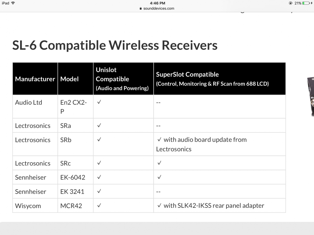

Hugh Palmer Posted October 8, 2017 Report Posted October 8, 2017 Does anyone know how well the superslot control will be with the 688 and sl-6? Quote
Movies by Matt Posted October 14, 2017 Report Posted October 14, 2017 On 10/7/2017 at 11:43 PM, Hugh Palmer said: Does anyone know how well the superslot control will be with the 688 and sl-6? This is where the old system stood. I'm sure with the recent distribution partnership, this will improve. On another note I was reading some Audio Ltd. literature and it seems the US A10 can record or transmit but not simultaneously, similar to the new lectro models. The A10 records to Audio Ltd.'s proprietary compressed format. I wish they would provide sample files for download. Ideally the same file recorded at the transmitter level and one through a SD 688/SL-6 kit so we could compare. Quote
