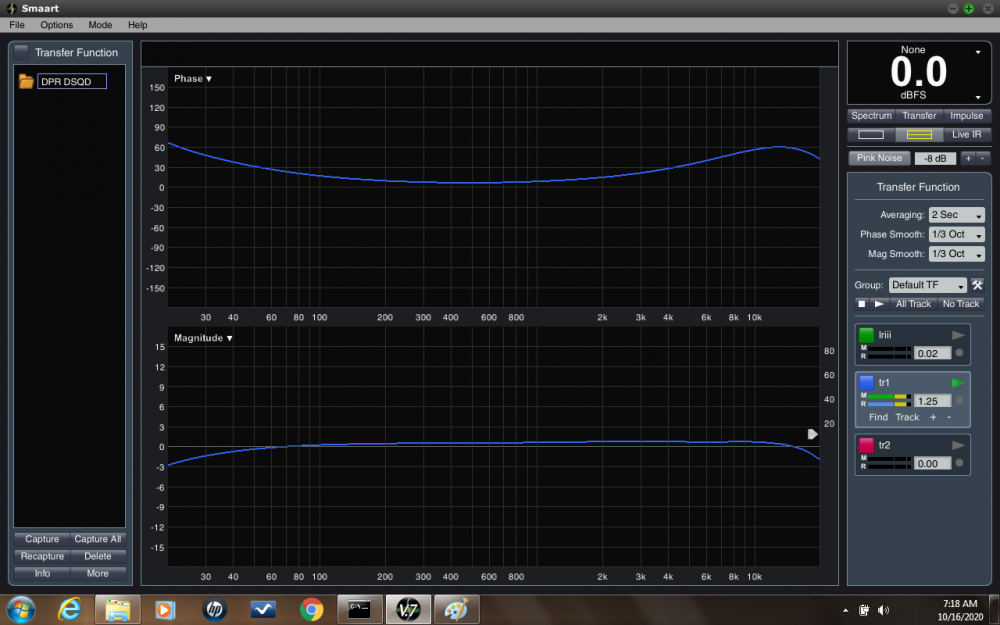

roundbadge Posted January 14, 2021 Report Posted January 14, 2021 Ive been experimenting using A10's side by side with DPR-a's running booms. they do sound slightly different . both sound good but the A10 sounds a little better to my ears..a bit more natural,fuller in the lower midrange. the DPR is a slightly little more rolled off below 120hz. Quote
karlw Posted January 15, 2021 Report Posted January 15, 2021 On 1/14/2021 at 2:56 AM, roundbadge said: Ive been experimenting using A10's side by side with DPR-a's running booms. they do sound slightly different . both sound good but the A10 sounds a little better to my ears..a bit more natural,fuller in the lower midrange. the DPR is a slightly little more rolled off below 120hz. Hi roundbadge, It may be interesting to note that the DPR system is quite flat in the low frequencies (see below trace showing frequency and phase response), especially when the HPF is set to 25 Hz (lowest setting). That said, there is a gentle rolloff down to -3 dB at 20 Hz. Perhaps the A10 has a slight bump in the lower frequencies? Nothing wrong with that - the goal is of course for these things to "sound good" which is certainly a subjective thing. Quote
TimMey Posted March 2, 2021 Author Report Posted March 2, 2021 On 1/14/2021 at 10:56 AM, roundbadge said: Ive been experimenting using A10's side by side with DPR-a's running booms. they do sound slightly different . both sound good but the A10 sounds a little better to my ears..a bit more natural,fuller in the lower midrange. the DPR is a slightly little more rolled off below 120hz. Thanks for the Input. I still try to decide... Recently I read a lot about RF-Noise (or hiss) with the A10s and i wonder, if there is a solution for this after all. Since i have several Mini-Cmit (all on different Cinelas, mounted with Quicklocks) and i want to keep this setup, is there anyone with the same setup and has problems? I know, there are some special (shielded) cables and chips from Audio Ltd. and you can also modify your Cinelas, but i rather like NOT to HAVE to do it. I know, the RF-spreading is a digital issue and i heard it on Zax as well, when the mic was to close to the Plug-on TX. Is it the same with the DPR Plug-on? Can anyone confirm this? And why is the DPR-A with the external antenna not available in Europe? Thanks very much everybody ! Quote
