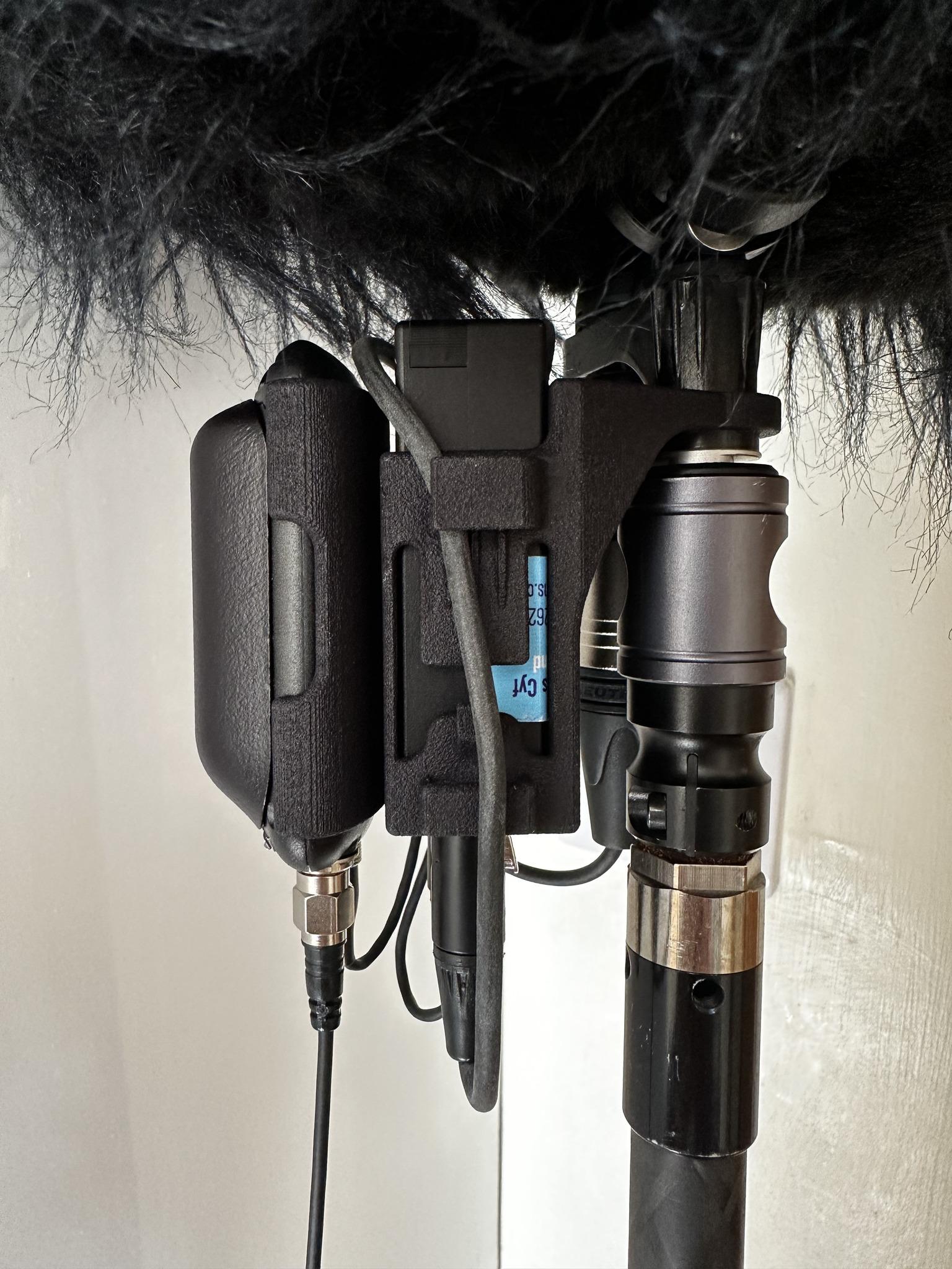

Soundwil Posted April 14, 2023 Report Posted April 14, 2023 Saw this on Facebook. Some people are using the A20 mini with UMP3 successfully it would appear. https://l.facebook.com/l.php?u=https%3A%2F%2Fwww.shapeways.com%2Fproduct%2FCFER6W76J%2Fboom-pole-bracket-a20-mini-ump3%3FoptionId%3D300277728%26li%3Dmarketplace%26fbclid%3DIwAR2ZPqrEGfewgD8zbUuLaf7W0onYOtpsavX8Em_jQIb2JWaYen2y-PB2w94&h=AT23lCPqVGwWOQZeeAGwTS7qeEIsph7f-dHlxNR_MHc4yox4_4pcZsSCJwDI93IbhTK1v-3lUX6uU88mgobprpGVyQREuLqJus_GcJtpHZEFdgwPch4o79uc_yhnjRzvZ9bnXrw&__tn__=-UK-R&c[0]=AT3jEbO3Vmj4n-_qUbC0geBIUpf3nUOPCek1aYgRpyFWIgh0IbQN47U9WlR3SsmWiQn-zpWqteJTxKDciD32MW4cubvU5mnK8xGup_eW4pICETCOopr9J_sTvzSjepi3mhljWWOh3ua6Jv5JQIwufMNWLnVQVcjpS5WN4ec I am not yet an A20mini user so literally just passing this on - no personal experience sorry. Quote
Jeff Wexler Posted April 14, 2023 Report Posted April 14, 2023 2 hours ago, Derek H said: That thing is a chunk fest!! Agreed. I would never want to put that amount of gack on the mic end of the fish pole. My boom operator would never do that. Quote
Patrick Farrell Posted April 14, 2023 Report Posted April 14, 2023 52 minutes ago, Jeff Wexler said: Agreed. I would never want to put that amount of gack on the mic end of the fish pole. My boom operator would never do that. It's a far cry better than the Denecke power supply and UM400 days. Still beats having a cable run around or through your pole. Quote
Johnny Karlsson Posted April 14, 2023 Report Posted April 14, 2023 40 minutes ago, Patrick Farrell said: It's a far cry better than the Denecke power supply and UM400 days. Still beats having a cable run around or through your pole. To each their own, I guess. I very much prefer an internally cabled pole with a plug-on at the bottom of the pole. Quote
