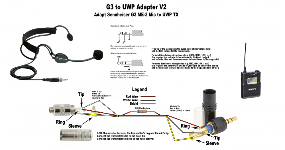

RevelRob Posted August 17, 2018 Report Posted August 17, 2018 Sorry to revive an old thread. I'm trying to make 2 adapters. The mics I have are both Headset Mics: Sennheiser ME 3-EW Headset Mic (older version of the ME 3-II) for G3. Sony ECM-322BMP Headworn Mic for UWP-D. I feel like I'm on the right track but just want to confirm before I do some more soldering (made some boo boos)... Is this correct? Thanks! Quote

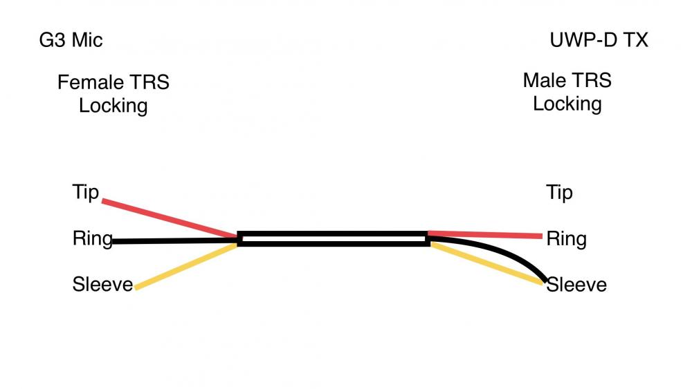

RevelRob Posted August 20, 2018 Report Posted August 20, 2018 On 8/16/2018 at 11:59 PM, RevelRob said: Sorry to revive an old thread. I'm trying to make 2 adapters. The mics I have are both Headset Mics: Sennheiser ME 3-EW Headset Mic (older version of the ME 3-II) for G3. Sony ECM-322BMP Headworn Mic for UWP-D. I feel like I'm on the right track but just want to confirm before I do some more soldering (made some boo boos)... Is this correct? Thanks! For anyone who is wondering, the above diagrams are incorrect if wanting to make ADAPTERS. After tons of trial and error and some amazing help by @Eric Toline and @Dalton Patterson, I ended up successfully making 1 adapter that will work both ways (G3 mic to UWP TX and UWP mic to G3 TX). If you want to make an adapter, you just need to wire Tip to Ring and Ring to Tip. Leave the Sleeve on both ends floating. Since the Sleeve is the part of both connectors that provide the most stability when soldered, be sure to use a good amount of heat shrink. Here's my adapter: I'll probably make another that's a bit longer and use a bongo tie to reduce stress on it since it is a bit top heavy. Quote
Eric Toline Posted August 20, 2018 Report Posted August 20, 2018 Congratulations on a job well done. I'm going to copy your diagram for my wiring cheat sheet. Quote

RevelRob Posted August 21, 2018 Report Posted August 21, 2018 On 8/20/2018 at 12:07 PM, Eric Toline said: Congratulations on a job well done. I'm going to copy your diagram for my wiring cheat sheet. Thanks for your help Eric! Regarding the diagrams, they are both INCORRECT if wanting to make an ADAPTER. Here is the correct wiring for an adapter: It will work both ways but since the Shield is carrying the load of 2 wires (shield and ring wire of the G3), it may not be advisable to use it the opposite way. If you want to make one to adapt a Sony mic to a Sennheiser TX, I'd suggest just doing the wiring like above but put the shield where the red wire would go and the red wire where the shield would go. All that said... I may have no idea what I'm talking about. Quote
Eric Toline Posted August 21, 2018 Report Posted August 21, 2018 I'm not sure if the labels on the 3.5mm TRS are for the wires or the solder points. If it's the solder points then they are reversed as the solder tab on the left marked as RING is the TIP solder point on that connector, same goes for the right side tab which is indicated as TIP but is connected to the ring on that connector. After further consideration and study I believe the Ring & Tip indicators show which wire goes where. Quote
RevelRob Posted August 22, 2018 Report Posted August 22, 2018 18 minutes ago, Eric Toline said: I'm not sure if the labels on the 3.5mm TRS are for the wires or the solder points. If it's the solder points then they are reversed as the solder tab on the left marked as RING is the TIP solder point on that connector, same goes for the right side tab which is indicated as TIP but is connected to the ring on that connector. After further consideration and study I believe the Ring & Tip indicators show which wire goes where. Yeah sorry, I shouldn't have colour coded the connectors. Just confuses things. Also, on my 3.5mm Female, the long tab has a "T" on it and a multimeter test confirms it's for the tip. It may just be how Switchcraft does it. Just found the datasheet actually: https://www.digchip.com/datasheets/parts/datasheet/000/35LJN-pdf.php Also, on the Male adapter I'm using, the Tip is the one that the Tip arrow is pointing to. Us Canadians have it all reversed! That said, to simplify... Female Tip to Male Ring with either Red or White wire (diagram shows Red). Female Ring to Male Tip with Shield. Female Shield and Male Shield disconnected (diagram shows White wires floating on both ends). Quote
