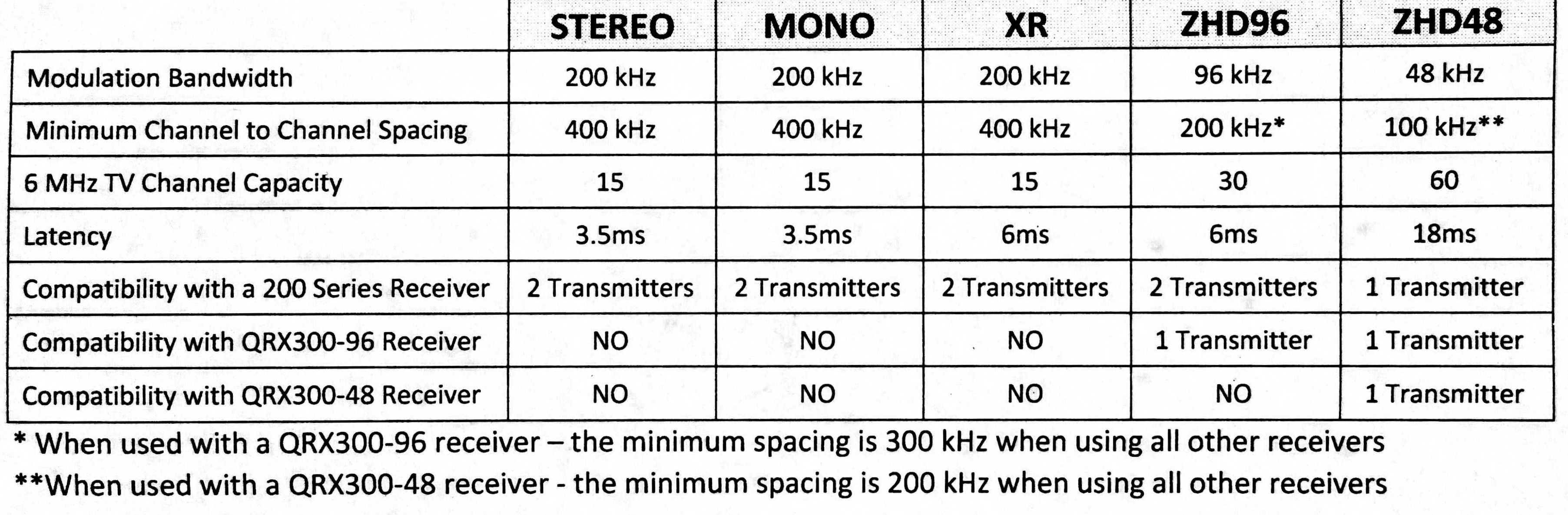

Mike H Posted August 16, 2016 Author Report Posted August 16, 2016 Thank you Glenn. Subsequently, I did get some good info from Nick at Gotham Sound NYC, plus your Tech Support: - I should be looking at the TRXLA3.5 and the QRX200. - The QRX200 can receive ZHD modulation, but cannot take advantage of the narrow bands. For my simple system with few channels this is not an issue. In fact, I should use XR instead because of slight advantage in sound quality and latency. - Your transmitter converts A-to-D, then transmits digital. The QRX200 can send either analog or digital to the Sound Devices 702, so digital out will avoid any conversions at that end. - There was some confusion on ADC sample rate (32kHz vs 48kHz), but in the specs for the TRXLA3 on your website I find it says 24-bit/48kHz. (48kHz is just right, much better than 32kHz). - Major advantages: Recorder in transmitter for backup (a big one); only one conversion (A-to-D) versus several (a big one); potential to use narrow bands with a different receiver in the future if my system becomes much more complex (maybe useful, but not any time soon).. So, for right now I have my questions answered, Glenn............except for a few more: - I am nervous about buying a receiver just before you produce a dedicated ZHD one. However, am I correct that a dedicated ZHD receiver is a poor choice for a simple system, since I could only use ZHD with the new receiver? - I am planning on buying the DPA 4060 mic, but I have gotten some advice that I should buy the 4063 to properly match bias. Then I've been told no, some users have had problems with the 4063 and Zaxcom receivers. I wish to buy the 4060, a tried and true product.........is this OK? - Any other major advantages I missed? Thanks, Glenn. Quote

Jack Norflus Posted August 16, 2016 Report Posted August 16, 2016 Mike this chart will help clarify things. Quote
