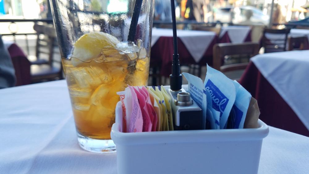

VASI Posted February 27, 2017 Report Posted February 27, 2017 4 hours ago, Jack Norflus said: Is this Long Island Iced Tea? Quote
The Immoral Mr Teas Posted February 27, 2017 Report Posted February 27, 2017 5 hours ago, Jack Norflus said: Well, I can see the aerial there, and when the mic's plugged in I envisage even more problems. Could you perhaps get a plant pot from props Jack and try that? Jez x Quote
John Blankenship Posted February 27, 2017 Report Posted February 27, 2017 47 minutes ago, The Immoral Mr Teas said: Well, I can see the aerial there, and when the mic's plugged in I envisage even more problems. Could you perhaps get a plant pot from props Jack and try that? Jez x I doubt Jack was offering that photo as an ideally hidden plant. I think it was just posted as an interesting size reference. Quote
Jeff Wexler Posted February 27, 2017 Report Posted February 27, 2017 I think it's basically a joke --- just there to show the size, not a real plant mic (and I agree with you, a potted plant would provide much better cover to camera!). Quote
Jack Norflus Posted February 27, 2017 Report Posted February 27, 2017 2 hours ago, John Blankenship said: I doubt Jack was offering that photo as an ideally hidden plant. I think it was just posted as an interesting size reference. Exactly. Quote
