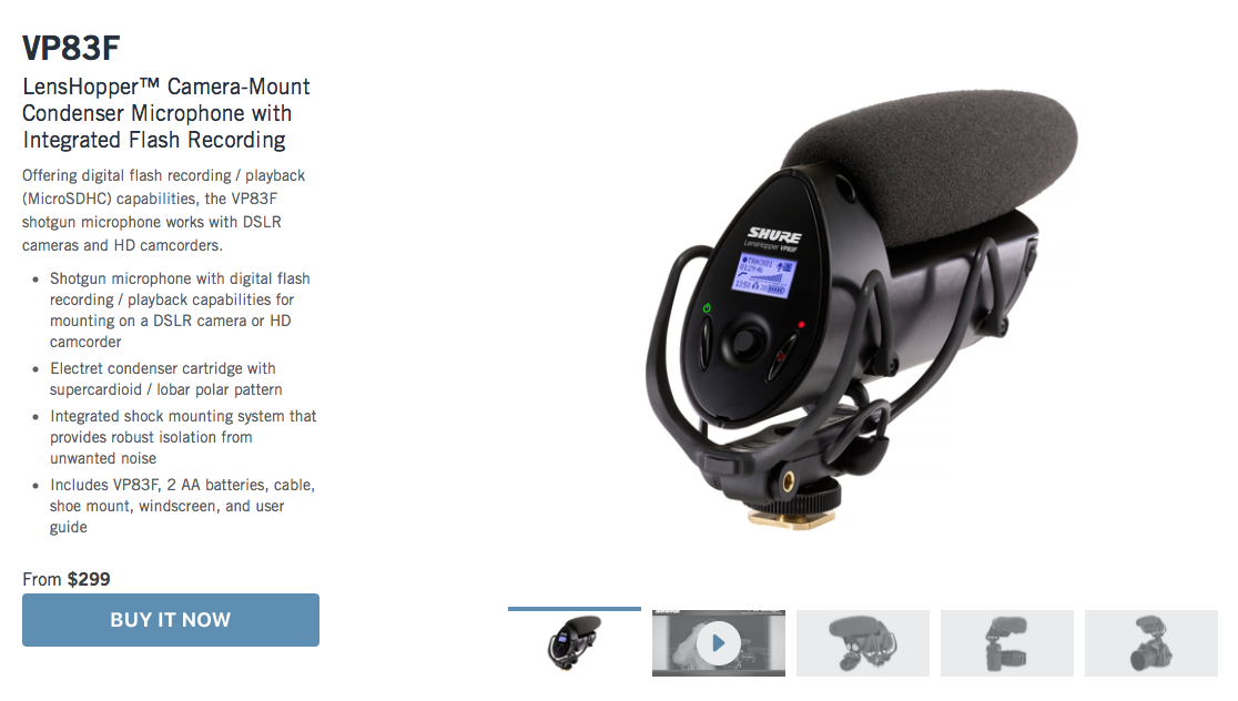

josephboyle Posted June 6, 2017 Report Posted June 6, 2017 It seems like you're complicating it too much. For your situation, a simple on camera shotgun like a Rode VideoMic might work fine. Even better, the Shure Lenshopper VP83F has an onboard microSD recorder and you can also send a backup to the camera. You can do some basic things to cut down on the noise that you are making with footsteps and such. If it's inside, take off your shoes, don't wear noisy materials, etc. Hope that helps. Quote

adrjork Posted June 7, 2017 Author Report Posted June 7, 2017 9 hours ago, josephboyle said: For your situation, a simple on camera shotgun like a Rode VideoMic might work fine. Even better, the Shure Lenshopper VP83F has an onboard microSD recorder and you can also send a backup to the camera. Yes, the Shure VP83F Lenshopper was my first thought, and it has a pretty decent polar diagram, it's more an hyper than a shotgun, and it has also a decent S/N ratio. And the flash recording option is important (to avoid the bad preamp of the camera itself). 6 hours ago, Mobilemike said: A Foley artist can do this a lot better than you could capture on set. It's true but unfortunately I'm not a foley artist, and as I've written before, I'm alone in this project, so I have to stand on my own two feet First of all, thank you all for your advices and your help. Anyway, just for curiosity, anyone can tell me which is in your opinion the less problematic mic for outdoor handling movements between AT4053B, SCX1hc and modified MK012? Quote

adrjork Posted June 7, 2017 Author Report Posted June 7, 2017 2 minutes ago, mikewest said: Did a test years ago for a producer and discovered that a half decent short shotgun mounted on the camera worked so well with the lens size and typical shots Thanks a lot Mike. Then I'll probably go for the Shure VP83F Lenshopper recommended by josephboyle. Anyway, just for my knowledge, anyone knows if there is a way to apply an operation, in post, to a 2-channel stereo track in order to obtain the only recorded space in common? (For example: L records both left and center, R records both R and center; I'd like to apply an operation to obtain the common center part from both channels.) Quote

josephboyle Posted June 7, 2017 Report Posted June 7, 2017 5 hours ago, adrjork said: Yes, the Shure VP83F Lenshopper was my first thought, and it has a pretty decent polar diagram, it's more an hyper than a shotgun, and it has also a decent S/N ratio. And the flash recording option is important (to avoid the bad preamp of the camera itself). Someone should let Shure know about that so they can update their website... Quote
