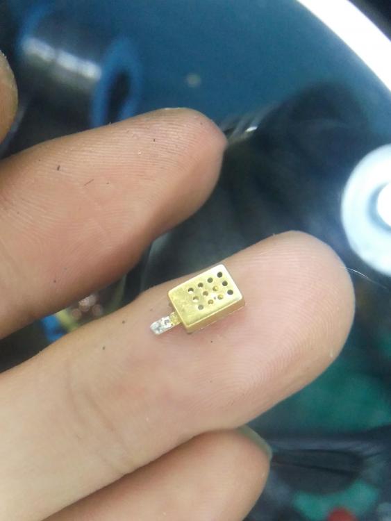

Natuz Posted November 10, 2019 Report Posted November 10, 2019 Greeting all, Sorry to brought this discussion again. I'm trying to fix a couple of 406x series. After a few trial errors I almost fix one of them. Does anyone here ever try to doing by yourself? PS: please don't ask me why I'm not sending it back to dealer or else. Because I'm in Indonesia, cost will be outrageous to send,fix,send it back. Thank you all Quote

Natuz Posted December 30, 2019 Report Posted December 30, 2019 On 11/16/2019 at 9:10 PM, vitekcz said: You mean fix connector or broken head of mic? To fix connector is not a big deal. I would love to be able fix the broken cable right under capsule. I have 3 mics now waiting to repair. The head mic. Quote
drpro Posted December 30, 2019 Report Posted December 30, 2019 Typically my 4060s fail at the head. With practice I could cut the plastic sleeve that surrounds the capsule off without damaging the capsule. DPA was nice enough to send me a number of the beige sleeves. Resoldering the capsule was for me the difficult part. My success ratio was about 3 out of 5 mics. Haven't tried any in a long while. Quote
