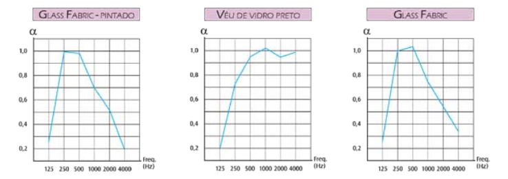

Rafael Posted February 23, 2019 Report Posted February 23, 2019 +1 Jay Rose completely agree ! there are a lot off possibilities on glass fiber panel cut it, frame it and please cover it with something neutral grey, withe or black options to make photographers happie. share with you some tech data Safe use instructions lana-vidrio-eng_0(1).pdf Quote

Removed Posted February 24, 2019 Author Report Posted February 24, 2019 13 hours ago, Rafael said: +1 Jay Rose completely agree ! there are a lot off possibilities on glass fiber panel Safe use instructions lana-vidrio-eng_0(1).pdf For sure -- I had great results with framed and covered mineral wool/rockwool, which is easier to deal with and great acoustic properties. Just trying to figure a way to throw them up against walls. 9 hours ago, TVPostSound said: Always start with the corners, that will alleviate 80% of issues. Absolutely right. 9 hours ago, Shastapete said: I still stand by my opinion that you should've patented this idea... +1 2 hours ago, mikewest said: Good answers Years ago I recorded a lot of scenes in and old house with picture rails om the wall about 6 feet from the floor. I bought furni-pads and had rings attached to an upper edges, then I bought old style picture hooks that the pads were then attached to hung from the picture rail Quick, light and easily moved to the next room location! mike Good stuff. Although all these things are ungainly and some trouble maybe, it seems like a better mindset to "treat the disease, not the symptoms" instead of just trying to solve it with mics. Like TVpostsound says, just covering the corners gets you most of the way home. Quote
