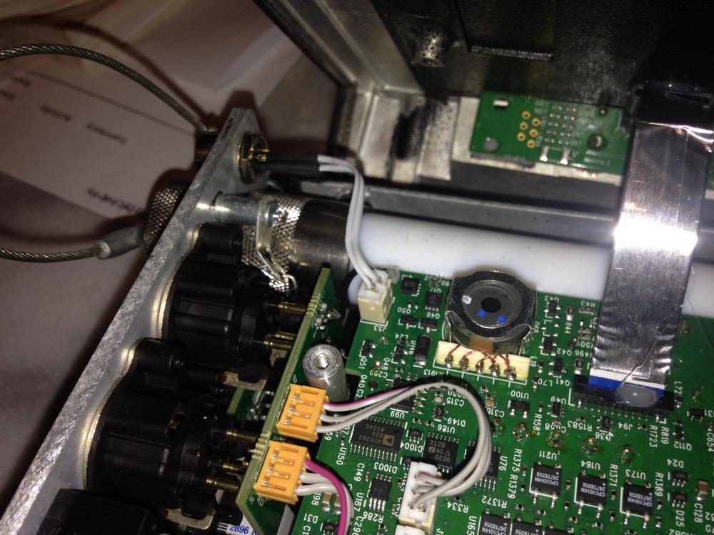

KenLac Posted September 4, 2020 Report Posted September 4, 2020 I'm very late on the draw here, but for anyone else experiencing a similar problem: the 664's external power connector is very user serviceable. I once had the retaining nut loosen to the point that the jack was floating around in the socket, so I took a look. The bottom of the case comes off with 12 fairly hefty philips-head screws. (Remove it gently, as there is a ribbon cable from the main board to the word clock sockets mounted into the back side of the bottom cover.) Once inside the external power jack is secured in with a regular old hex nut, and the lead goes to the main board on the same kind of plug connector that you commonly see for CD-ROM audio in computers. It's very easy to diagnose and replace the physical connector. Quote
