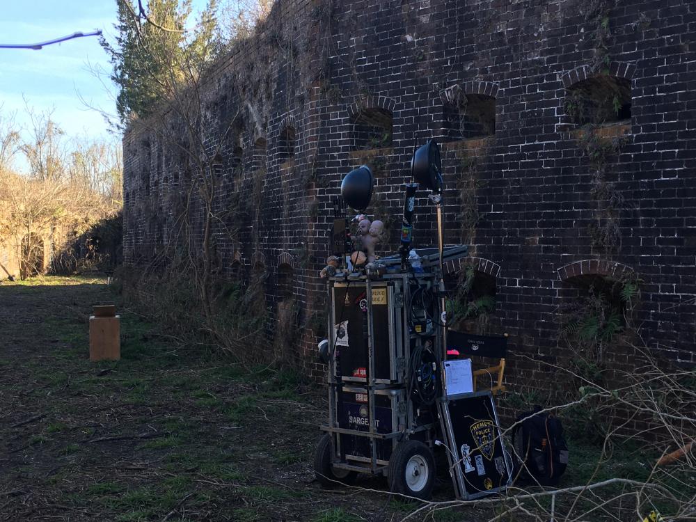

Izen Ears Posted July 4, 2021 Report Posted July 4, 2021 Sharkfins are nice, small, and they have a cool name. But if you have the room on your new cart, no other passive antenna can beat PW’s helicals. These smaller ones are ridiculously awesome. Around corners, through metal, I’ve really only had issues with being stepped on or like 400’ away. Not cheap, but you won’t ever have to replace em! https://www.professionalwireless.com/product/domed-helical-antenna/ Dan Izen Quote
Constantin Posted July 8, 2021 Report Posted July 8, 2021 On 7/2/2021 at 7:27 AM, Mungo said: Seems like Zaxcom is cheaper than Shure and even Remote Audio (huh?) Remote Audio isn‘t a cheap brand… But you’re only referring to whip antennas, right? Because Remote Audio only make whips… On 7/4/2021 at 9:03 PM, Izen Ears said: no other passive antenna can beat PW’s helicals So do you have two of those for diversity? Quote
Izen Ears Posted July 15, 2021 Report Posted July 15, 2021 On 7/8/2021 at 4:47 PM, Constantin said: Remote Audio isn‘t a cheap brand… But you’re only referring to whip antennas, right? Because Remote Audio only make whips… So do you have two of those for diversity? Yep! Quote
Alex Milne Posted July 24, 2021 Report Posted July 24, 2021 Seeing your cart Izen, which has two of PW's helical antennas on it, reminds me of a conversation from the good old days I had with a physicist - unaffiliated with any manufacturer - on the use of twin helical antennas on diversity receive systems. Some of your probably know that helical antennas come in two basic flavors determined by their polarization: whether the winding of the "helical" element turns to the left, or, to the right. E.g. whether the antenna wire within the helical housing spins clockwise or counterclockwise. In the antenna industry (and in PW's product terminology last I checked), helicals are designed as either "Right Hand Circular Polarized" (abbreviated as RHCP) ,or, "Left Hand Circular Polarized" (abbreviated as LHCP). He (physicist) was of the opinion that using an intentionally opposing pair of (1) RHCP helical on diversity channel A, and (1) LHCP helical on diversity channel B, is the best possible configuration for avoiding dropouts. Restated: a diversity pair of RHCP + LHCP helicals might be a great upgrade vs. whips toward maximizing range, minimizing dropouts - under a given set of RF conditions. If you have the cart space, anyhow. Hope everyone's staying safe out there, -Alex Quote
codyman Posted July 25, 2021 Report Posted July 25, 2021 On 7/15/2021 at 6:47 AM, Izen Ears said: Yep! Is the creepy two headed doll a sacrifice to the RF gods in hopes of having a clear scan and no drop outs every time? I've never considered helicals before for a cart setup. Seems interesting... Quote
Izen Ears Posted July 26, 2021 Report Posted July 26, 2021 On 7/24/2021 at 1:32 PM, Alex Milne said: He (physicist) was of the opinion that using an intentionally opposing pair of (1) RHCP helical on diversity channel A, and (1) LHCP helical on diversity channel B, is the best possible configuration for avoiding dropouts. Restated: a diversity pair of RHCP + LHCP helicals might be a great upgrade vs. whips toward maximizing range, minimizing dropouts - under a given set of RF conditions. Oh wow! I have to check these, I bet they’re both wound the same way. If so, I will probably get see if they can reverse one of em. 20 hours ago, codyman said: Is the creepy two headed doll a sacrifice to the RF gods in hopes of having a clear scan and no drop outs every time? The creepy dolls are all donations, and I feel they’re more of a messed up mast head than a sacrifice. Maybe if I was having a rough RFI day, I could burn one and see if it clears up haha! Dan Izen Quote
