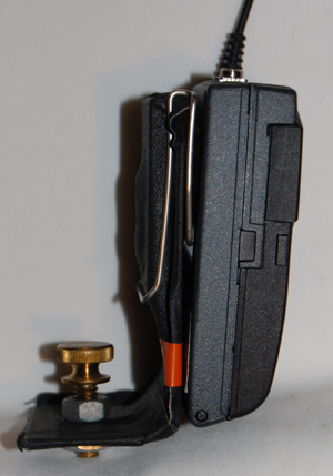

sounddguy Posted June 6, 2013 Report Posted June 6, 2013 For the cheese plate rig cameras, I took a strip of brass from the hardware store, mounted a thin strip of wood to match a G2 clip size and covered with gaff. The bottom nut is usually removed before mounting. A quick and easy mount for a G2/3 RX Quote
