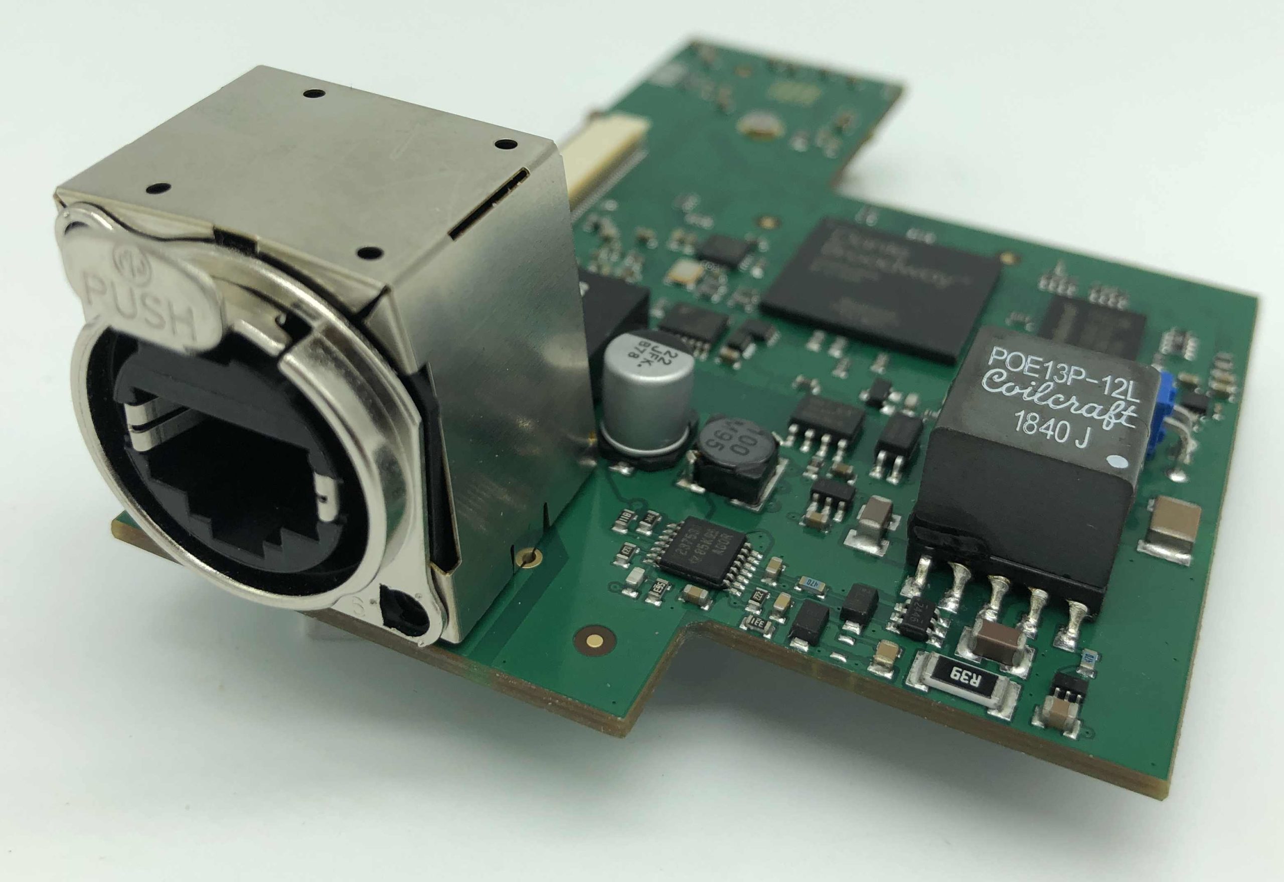

Patrick Tresch Posted September 18, 2019 Report Posted September 18, 2019 Good news for DANTE users. The Dante option: announced, postponed, long awaited, it arrives this time for good. Our card now operates according to the criteria we had defined, particularly in terms of consumption. Powered by PoE, it is the least energy consuming on the market and will therefore not shorten the autonomy of your batteries too much. You will be able to connect the multi-channel interface to your SX-AD8+ before the end of the year. The SX-R4+ will have to wait until early 2020 to click its RJ45. https://www.sonosax.ch/sononews-september-2019/ Quote

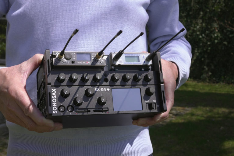

DanieldH Posted April 21, 2021 Report Posted April 21, 2021 Sonosax announced a not so super- but minislot module https://www.sonosax.ch/sononews-april-2021/ Quote
codyman Posted April 21, 2021 Report Posted April 21, 2021 6 minutes ago, DanieldH said: Sonosax announced a not so super- but minislot module https://www.sonosax.ch/sononews-april-2021/ Seems slick, I like the boxiness yet functionality of it. Kind of a bummer it doesn't have an antenna distro though. I do like whatever those heavy duty sma antennas they are using on the SRb though. I wonder where they got those from as I'd be interested a few of those myself! Quote
Neil Mc Posted April 22, 2021 Report Posted April 22, 2021 19 hours ago, DanieldH said: Sonosax announced a not so super- but minislot module https://www.sonosax.ch/sononews-april-2021/ A thing of beauty! Quote
Patrick Tresch Posted April 22, 2021 Report Posted April 22, 2021 Jacques told me that he didn't want to put a antenna splitter as it's allways a compromise for best signal unless you use a finn. He also opted not to use the superslot system mainly for size and weight reasons. They worked on the mechanics to make it user friendly. Quote
codyman Posted April 22, 2021 Report Posted April 22, 2021 I'm curious to know how the 8 fader pots work on that thing. If you're using two analog 2 channel slot receivers, do just the first four pots work? Are they assignable? Quote
Patrick Tresch Posted April 22, 2021 Report Posted April 22, 2021 They can be assignable through the menu of the SX-R4+ or the 8 series from Sound Devices. Look at it like a remote control like the SX-RC8+. Quote

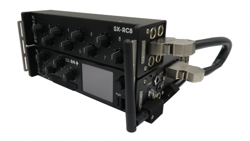

docsound Posted April 28, 2021 Report Posted April 28, 2021 On 4/22/2021 at 8:51 PM, Patrick Tresch said: Jacques told me (…) He also opted not to use the superslot system mainly for size and weight reasons. They worked on the mechanics to make it user friendly. How will the receivers be connected to the recorder? Is there a D-sub port inside or just nothing and you need to use some cable like this: https://www.sonosax.ch/product/002357/ Quote
DanieldH Posted April 28, 2021 Report Posted April 28, 2021 3 hours ago, docsound said: How will the receivers be connected to the recorder? Is there a D-sub port inside or just nothing and you need to use some cable like this: https://www.sonosax.ch/product/002357/ Like that: (connectors are 3M MDR26) Quote
docsound Posted April 29, 2021 Report Posted April 29, 2021 10 hours ago, DanieldH said: Like that: (connectors are 3M MDR26) Thank you! But I mean how the receivers will be connected inside the RX8? D-sub? Quote
DanieldH Posted April 29, 2021 Report Posted April 29, 2021 6 hours ago, docsound said: Thank you! But I mean how the receivers will be connected inside the RX8? D-sub? On the video Patrick posted, you can see briefly how Jacques inserts an A10 RX with what should be the DB25 Panasonic/Ikegami style connection. Quote
