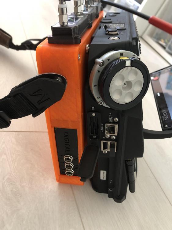

Csaba Major Posted August 2, 2020 Report Posted August 2, 2020 I’ve 3d printed a box for the receivers. There is no cover for mini, but it doesn’t need. If i have to work in rain, i will use a rain poncho. The box and the mini assembled with a screw at the mini‘s bottom. The sennheiser IEM transmitters are fitting at the strap. (2pieces series2000 transmitter with 100mw) so there is 6wireless and 2 ifb line, and i have a pair of mic/line analog input. this rig is cca 4.5 kg with batteries. it can work for 4 hours with 2 aaton batteries. (At least 3,5hours) Quote
daniel Posted August 3, 2020 Report Posted August 3, 2020 On 8/2/2020 at 8:26 AM, Csaba Major said: I’ve 3d printed a box for the receivers. There is no cover for mini, but it doesn’t need. If i have to work in rain, i will use a rain poncho. The box and the mini assembled with a screw at the mini‘s bottom. The sennheiser IEM transmitters are fitting at the strap. (2pieces series2000 transmitter with 100mw) so there is 6wireless and 2 ifb line, and i have a pair of mic/line analog input. this rig is cca 4.5 kg with batteries. it can work for 4 hours with 2 aaton batteries. (At least 3,5hours) Very nice. Hydra? MCR54? Is possible to post pics of how you fixed this to MiniX3 I'm guess through the orange body when not populated. I like the way you continue to use the same 'button hole' (sony) style strap. Quote

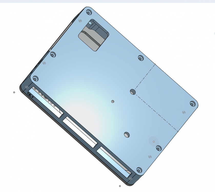

Csaba Major Posted August 15, 2020 Report Posted August 15, 2020 The two holes for hold the mini. One for the mini's bottom screwhole, and on for a pre printed cube to hold mini in place. If you can see the mini's bottom, there is two rectangular form blind hole. Quote
