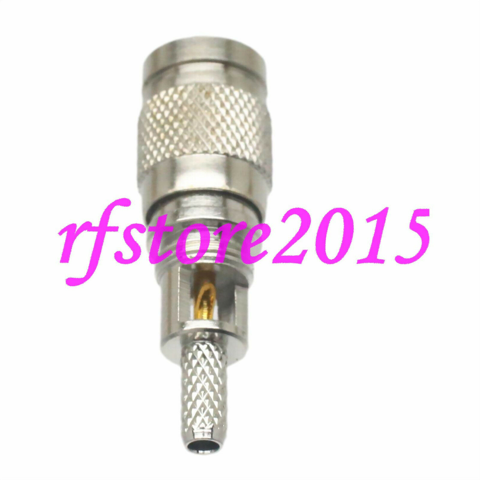

Sound Posted August 18, 2020 Report Posted August 18, 2020 Now I got all my cables and the crimping tool shipped from china, I just tried to install the SMA Connector on a cable. But I cannot get the copper pin out to crimp it on my cable. Usually the copper pin in the middle of the plug is shipped separately so you can crimp it on and then just click it into the plug. Does anyone know how to get it out? https://www.ebay.de/itm/223480639309 Quote
Shastapete Posted August 18, 2020 Report Posted August 18, 2020 4 hours ago, Sound said: Now I got all my cables and the crimping tool shipped from china, I just tried to install the SMA Connector on a cable. But I cannot get the copper pin out to crimp it on my cable. Usually the copper pin in the middle of the plug is shipped separately so you can crimp it on and then just click it into the plug. Does anyone know how to get it out? https://www.ebay.de/itm/223480639309 It isn't an SMA, but a DIN 1.0/2.3 connector. In the connector you linked on ebay, it isn't a crimp for the center pin, but solder as you can see the solder cup in the product images, also why there is a big opening around it. You need to prep your center conductor to exactly reach with just enough jacket removed to fit into the cup Quote
