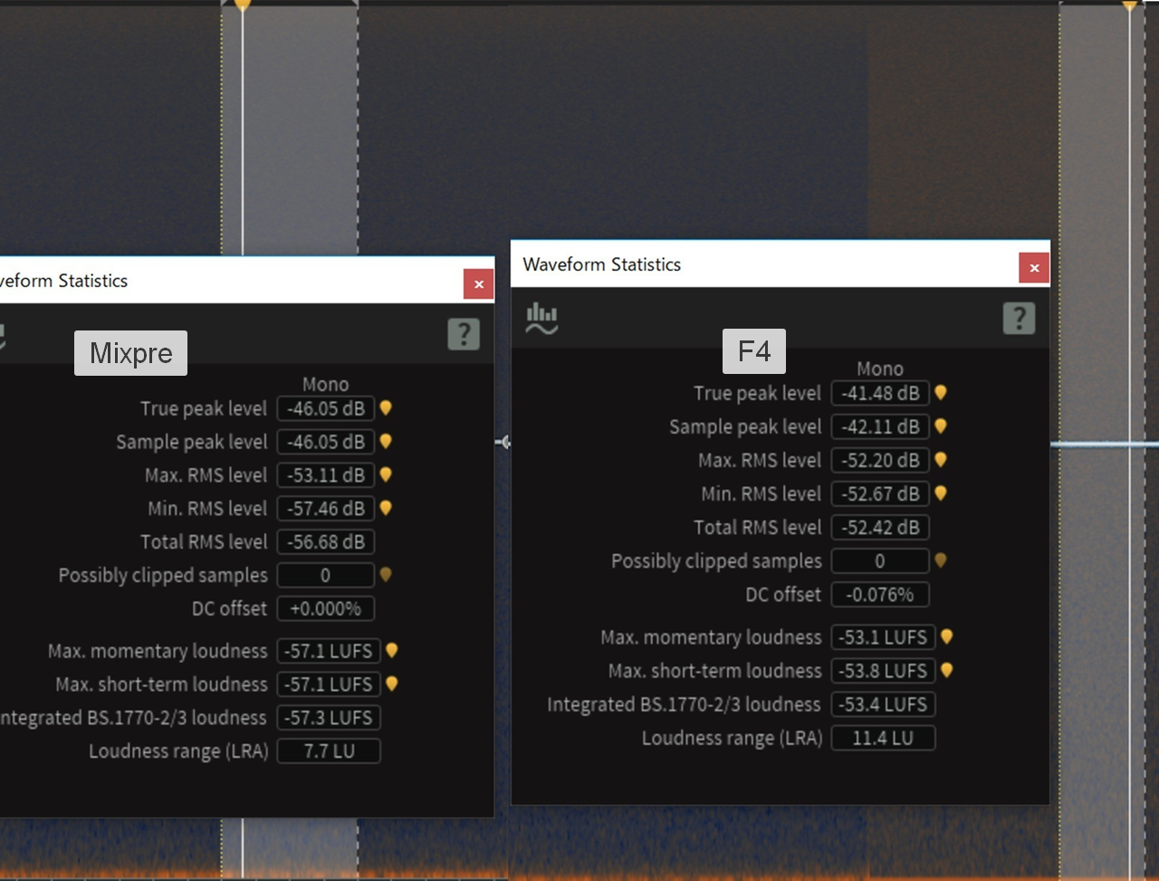

INARI Posted March 12, 2018 Report Posted March 12, 2018 I compared the noise floor of ZOOM F4 and Sound Devices MixPre-10T. According to the spec sheet, the performance of the MixPre-10T's preamp seems to be the same as MixPre-3 probably. I soldered 150 ohm resistor between 2-3 pin in XLR Male Plug.It emulates a 150 ohm dynamic microphone that switched off. and aligned to trim +75 and fader +0 both recorder. Then hit record button. The following test results were obtained.... The MixPre's noise is slightly thinner than F4. F4 has a signal like a dense ham noise under than 1Hz. Looking at the analyzer, MixPre seems a bit quieter than F4. I love either recorder. But I am a Japanese. So I'd like to vote to ZOOM with motherland favoritism. However,If I choose recorder by sound quality. I choose SoundDevices. Quote

IronFilm Posted March 12, 2018 Report Posted March 12, 2018 This will explain it for you:http://www.rane.com/note145.html But basically the core point you can take away from this is you're unlikely to ever tell the difference between a well recorded F4/F8 recording and a well recorded MixPre3/6/10 recording in anything but a carefully done A/B test under controlled environments (like the excellent one INARI did). So personally, I wouldn't let the noise floor of the pre amps between the F4 and the MixPre3 be any factor at all in your decision. Instead concentrating on other factors such as their functionality and how they help make your day smoother or not when actually shooting on location. (this is where things like layout, user interface, internal TC generator, full size XLR outputs, etc... end up matter. And mattering far more than the noise floor of one pre amp vs another) Quote

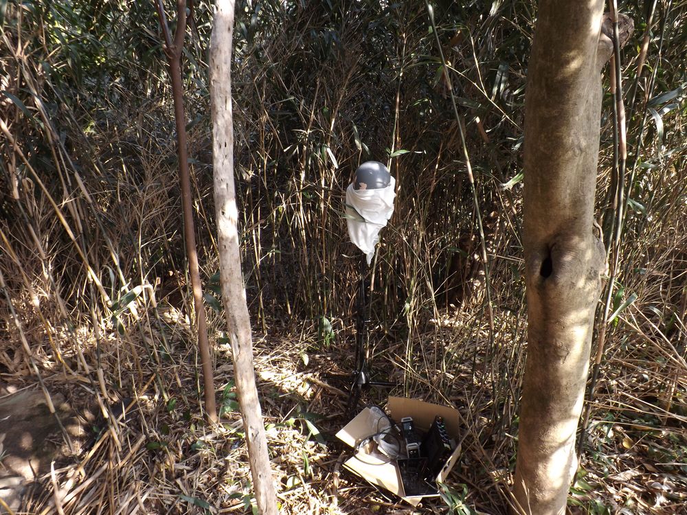

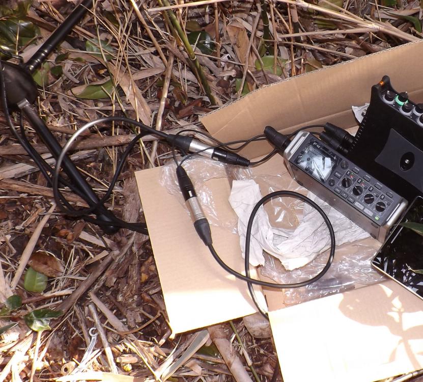

INARI Posted March 13, 2018 Report Posted March 13, 2018 Today I recorded 2 binaural files for comparison. Aligned to same gain and same fader in both recorders. Nonetheless, ZOOM F4 file is about 4 dB louder, so I will also attach 2 normalized files with -4dB. Equipments are DavinchHead Mk.2 Binaural Mic (Primo EM173 Microphone x2 with zener diode and fet) Mogami 2534 cable (Mic-to-YCable) Mogami 2901 cable(YCable-to-Recorders) Neutrik and cheap made in China connectorNow hear it!!(Downloadable) (96kHz 24bit files)https://drive.google.com/file/d/1tLPTwAA7jWsw4f4vT1XJ3q9Tm4ZwDm04/view?usp=sharing I feel MixPre is somewhat better sound,but the difference is negligible. It may be prominent when recording music,but I am not organizing a band for now unfortunately. However,both are practical recorder surely. I think the important thing was an appropriate setting as IronFilm says. Quote
