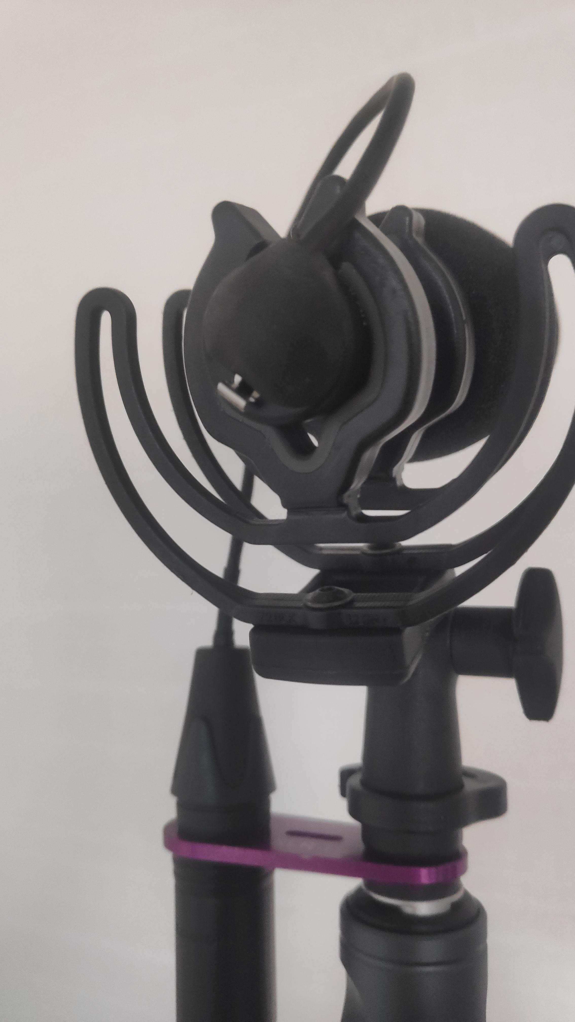

DanieldH Posted August 19, 2021 Report Posted August 19, 2021 I am currently booming with this mic in low ceiling situations (a cruise ship) and am pretty impressed with it. I've worked a lot with the miniCMIT and love it but these extra centimeters less are a boon on the boom. My setup with the "Sugru"ed (and shortened) ultra slim DPA DAO4010: Quote
