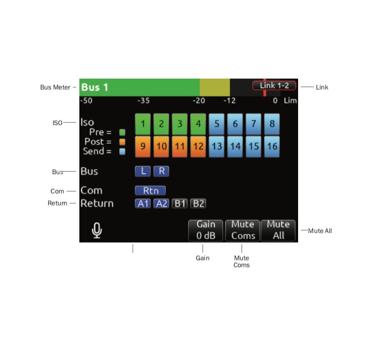

JHS2 Posted January 26, 2020 Report Posted January 26, 2020 I give. On the Bus sends there is green for pre, orange for post but what is the blue for? Quote
bcopenhagen Posted January 27, 2020 Report Posted January 27, 2020 As a a new 888 owner, I was curious to know. At first glance through the manual for the 888 , the only reference to the blue color is in a photo screenshot of the Bus 1 screen. In the legend in the top left corner, it says Send = <blue box> (See attached image from the 888 manual). I will keep looking, but that’s the first clue. Quote
mano Posted January 29, 2020 Report Posted January 29, 2020 Blue means it's a Send. So you can define a value of how much is sent to the bus. I think this is controlled in the channel setup screen of the specific channel. Manual page 8 CHANNEL TO BUS ROUTING Determines to which bus or buses the channel audio will be sent. When a channel is routed to a bus as a Send (bus box highlighted blue), the Send Gain value is used. When a channel is sent Pre (green) or Post (orange), the Send Gain value is ignored. I hope Im right and this is helpful. Quote
paul isaacs Posted January 29, 2020 Report Posted January 29, 2020 Mano - you are correct! Blue allows you to create mixes independent of the pre or post fader gains feeding the main mix. This technique is often used for creating custom monitor mixes for musicians but could also be useful for creating personalized IEM feeds on set. Quote
Tom Craca Posted January 29, 2020 Report Posted January 29, 2020 I have to do this often on live remote anchoring sets for network news and sports. Often the host/talent have IFB ear molds in their ears and can't hear their guests / other talent sitting or standing right next to them well, especially in high noise environments. They each need each others iso's blended in lightly for a mix minus on set. It was always a struggle with the 688 having no control of the send to aux levels of the ISOs; I'd have to provide the remote program feed hot to each aux talent in-ear monitor so the ISO pre-fade (of the others) to the aux was at a lower level. It was a delicate and painful dance. On the 8 Series with the aux send option it's a breeze. One of the many reasons I added a 833 and Scorpio. This is a great feature that you don't know you needed until you had the option. Quote
