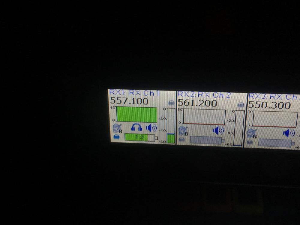

Brian Posted September 12, 2019 Author Report Posted September 12, 2019 Hey guys, I have updated the firmware through wireless designer. Last night. It’s supposed to address a bug apparently that causes the Unit to switch antennae for no particular reason. So maybe what I was hearing was an antennae switching fault. I am running the DSQD now with venue Wideband mid as the front End using the loop thru. So far so good as I am in a very RF demanding set with Star Trek Season 3 Tandem Unit. Niggles I have are the discrepancy between the battery readout. Comparing the venue and DSQD, the differences are large. One more decimal of readout would be nice, as I am used to the readouts on the venue. It would also be nice to see the External voltage displayed somewhere. Sound Quality is excellent so far, matching the Venue. More to come. Shout out to Lectrosonics Canada’s Joe Burtinski for calling down to the Mothership and talking directly with the DSQD designer. He also notified me right away about the firmware update. Quote

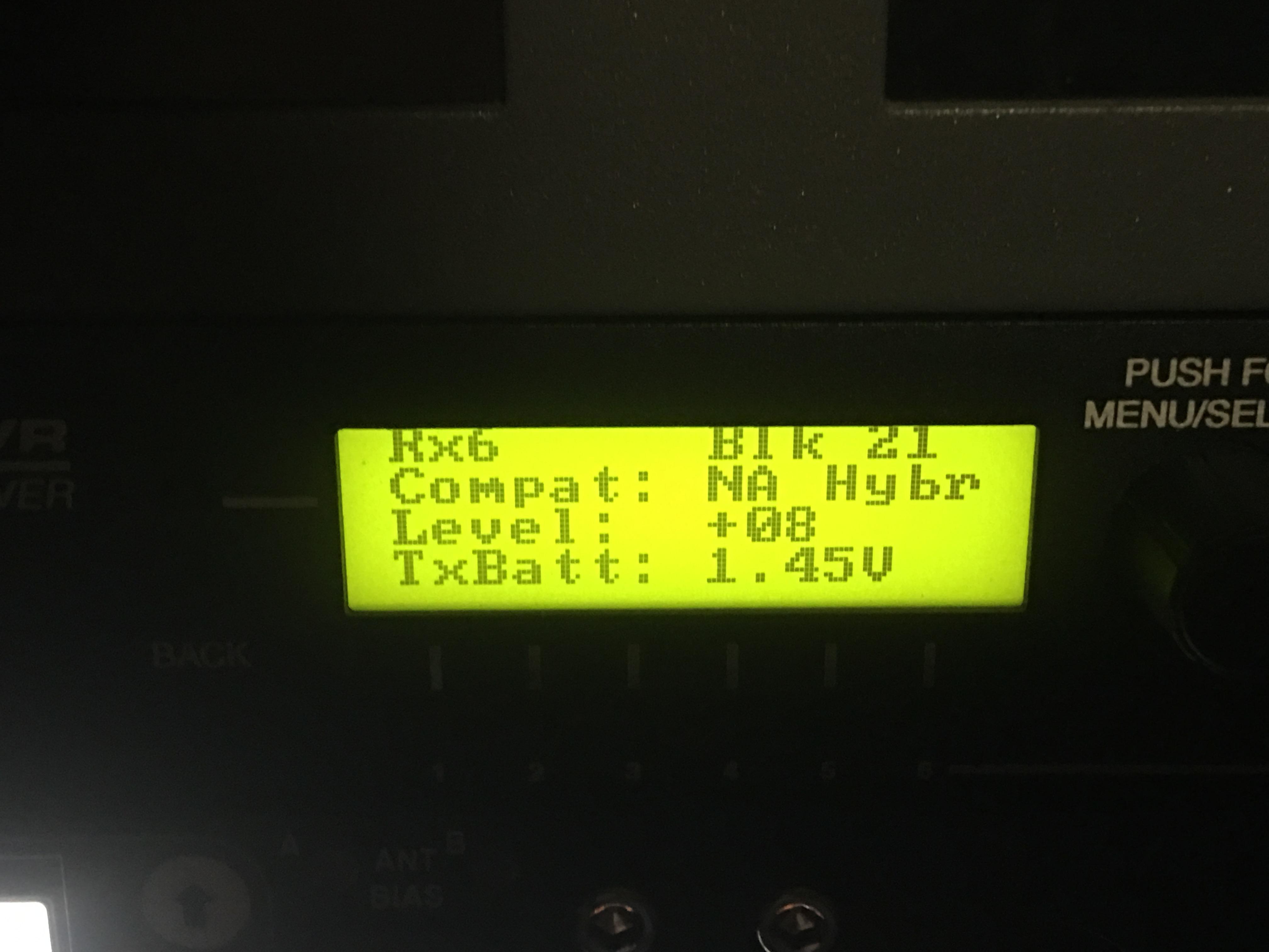

LarryF Posted September 15, 2019 Report Posted September 15, 2019 Hi Brian, If this is happening in the hybrid emulation mode, everything I said about switching during headers is not applicable since there are no headers in hybrid mode. I mention this because the display picture shows NA Hybrid mode. Best Regards, Larry Fisher Quote
LarryF Posted September 16, 2019 Report Posted September 16, 2019 15 hours ago, Brian said: It is Hybrid mode yes. In Hybrid mode you will have the same low level tics during antenna switching as in a standard Hybrid receiver such as an UM411a. In full digital mode, those antenna switches are done during the dead time of the header information so the tics are totally hidden. That header is nonexistent in Hybrid emulation mode. If you have a Hybrid receiver, set it up at the same exact audio output level (in your headphones or speakers) as the DSQD. Now evaluate the low level tics from both units. Remember, the DSQD is trying to emulate a Hybrid receiver exactly. Those tics are typically down in the noise floor if the transmitter is gained properly. Best Regards, Larry Fisher Quote
