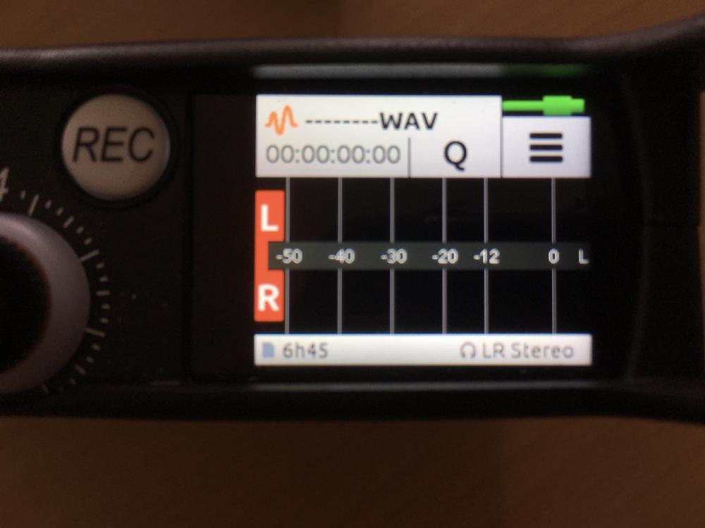

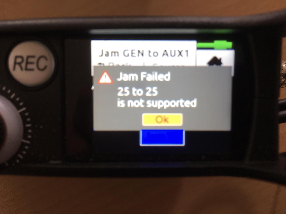

T Spear Posted February 3, 2020 Report Posted February 3, 2020 Hi folks, My mix pre 6 II is not behaving at all with timecode. I can not even get it to roll time of day timecode let alone jam.The screen just reads all zeros. Once trying to jam the screen actually came up saying 25 to 25 (as in frame rate)is not supported! It is on the latest version 6 I can set the aux in to receive timecode and the display then matches my ultra sync one but am unable to even jam to this. I have owned and extensively used SD gear since the beginning (442) and have never had any timecode issues. If anyone can offer up a possible fix in menu settings that I am unaware of, or has had this issue addressed by the good people at Sound Devices please let me know. Thanks. Quote

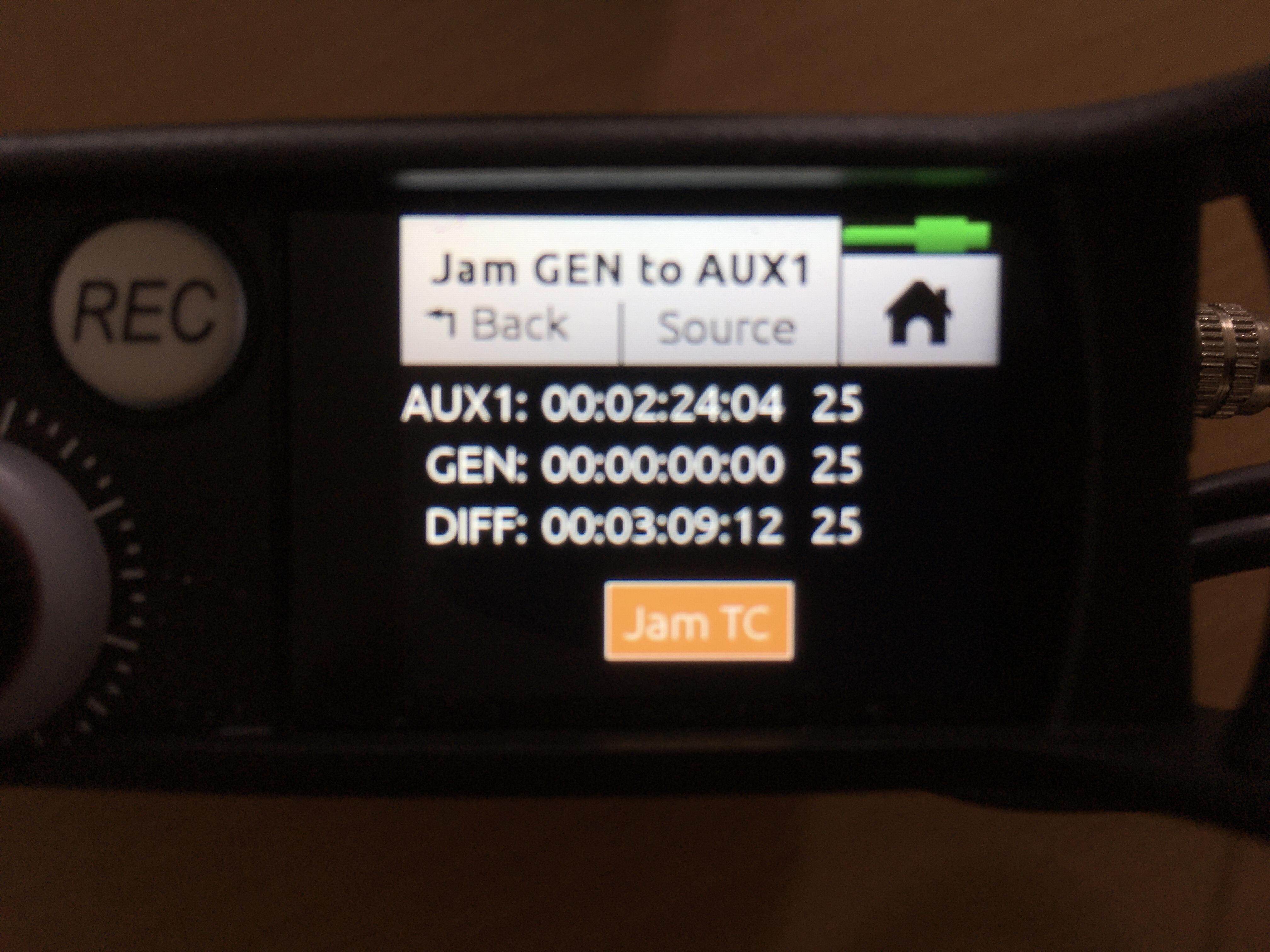

T Spear Posted February 4, 2020 Author Report Posted February 4, 2020 Hi All, Thanks again for your replies. There is nothing much you can do wrong with these Mix Pre2s if they work as they should. My one will be heading back to sd before I even got to use it on a really simple shoot. I have re updated the version 6 software and the timecode rolled as time of day and all syncing options worked however upon a power off and back on the line of zeroes returned with the same timecode issues. I have uploaded some screen shots. My main question was that has anyone had this issue or similar with timecode and a mix pre 2. Thanks. Quote
Display Name Posted February 4, 2020 Report Posted February 4, 2020 "Jam GEN to AUX 1" is when you want to Jam the MixPre from an external TC source feeding its TC on AUX 1 input, right? If you try that you need to set the USO to be the TC gen and output LTC on one of it's two ports. Quote
IronFilm Posted February 4, 2020 Report Posted February 4, 2020 That DIFF is surely not correct? Look at the three numbers, the math doesn't make sense. Quote
T Spear Posted February 4, 2020 Author Report Posted February 4, 2020 Hi again, As you can see from the pics my mix pre doesn't seem to know what time it is. Off to the shop. SD service is very flash. Thanks for your ideas and comments. Quote
TVPostSound Posted February 5, 2020 Report Posted February 5, 2020 After 4 hours powered off, mine boots with 00.00.00.00, but a split second later, I get a timecode was reset notice. Time of day returns. So I guessing your timecode is not resetting. Have you tried downgrading the firmware, the upgrade again?? Quote
