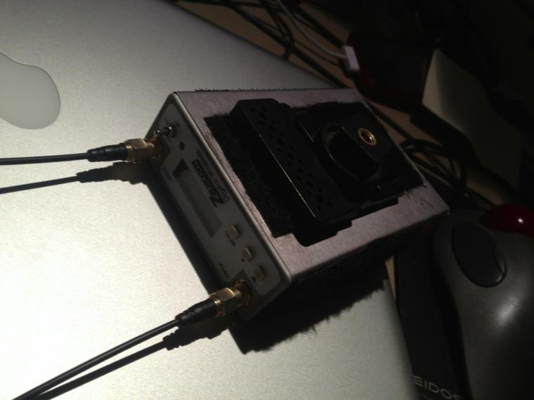

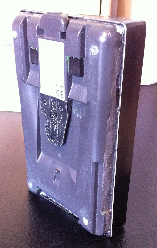

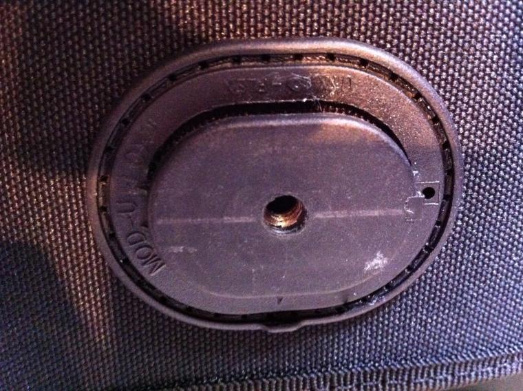

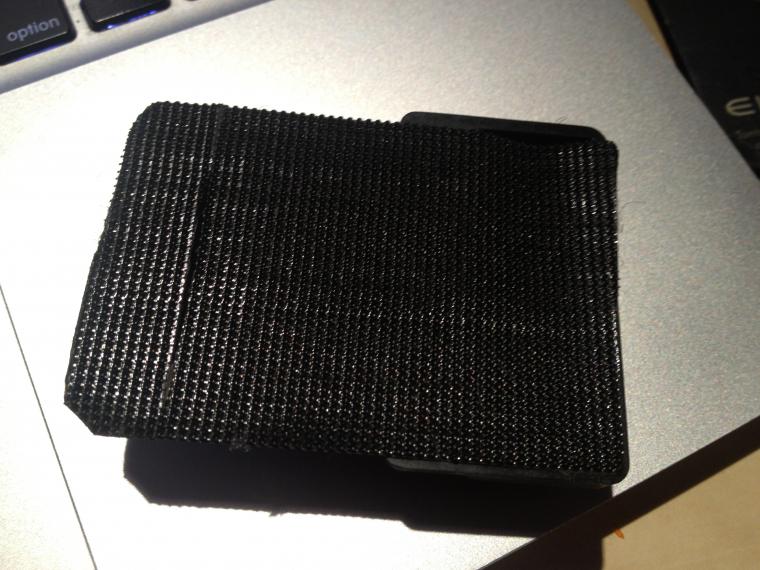

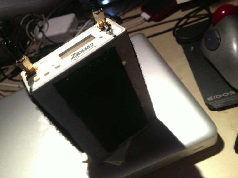

Matt Morris Posted March 24, 2013 Report Posted March 24, 2013 I messed around with different mounting methods for a while. When not in cam hop mode, I use my rx in my bag in a petrol pouch so modified it so it could be attached to different cameras quickly and easily. Drilled a hole in the centre of the pouch buckle, tapped a thread and glued a nut underneath: Now the pouch can be mounted on a camera hotshoe using an adapter: I also made a V-Lock mount by gutting an old IDX battery. It can be piggy backed on to V-Lock batteries that have a female attachment. Managed to track down some of the Mod-U-Lox buckles that Petrol use on their pouches from here: http://www.ahh.biz/hardware/miscellaneous/ The MDF finish isn't too pretty at the moment so I'm planning to spray it black. Does the job though. Quote
