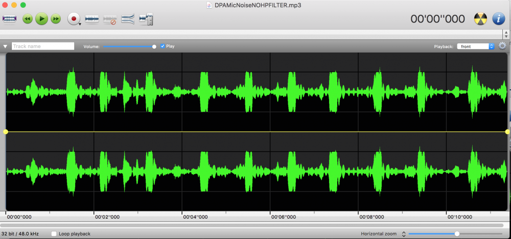

MartinTheMixer Posted February 11, 2017 Author Report Posted February 11, 2017 With90hzHP.mp3 DPAMicNoiseNOHPFILTER.mp3 1 hour ago, r.paterson said: I had this on Maxx..is the hpf set to off or low setting , setting hpf to 90-100hz cured it....could be something similardit was LF distorting the a-d on input channel...richard 1 hour ago, ramallo said: Can you upload a recording with the noise? 1 hour ago, cineli said: Martin, I totally understand that it is not a rumble noise, but you are speaking about a noise that occurs with two different mikes when you bump the body. This can be a case where the very high amplitude of the rumble can affect preamps, limiters, transmitters, etc... Let me join Philip's answer: does it occur with other systems ? any kind ? 2 hours ago, Philip Perkins said: Does this noise issue persist when you plug those mics into another system, like a mixer or other recorder? 4 hours ago, Whit Norris said: What pole are you using and what mic are you using? Hi All and thanks for the help.The recordings I just uploaded are with 90 HZ HP turned on and turned off. I am taking the pole and swinging it really hard, then snatching it to a stop. The noise you hear is from the sudden deceleration. I have never heard this before. Sincerely, Martin Quote

MartinTheMixer Posted February 12, 2017 Author Report Posted February 12, 2017 2 hours ago, al mcguire said: AL, we are looking at what? Sincerely, Martin Quote
Constantin Posted February 12, 2017 Report Posted February 12, 2017 AL, we are looking at what? Sincerely, Martin That's your files. Look at the header Quote
cineli Posted February 12, 2017 Report Posted February 12, 2017 Martin, all I can say is: what I hear and know let me think about a hard rumble issue, but maybe I'm wrong of course. The 4017C is well known to provide a high level of rumble that needs to be filtered. About Nomad, I had a look at characteristics (documentation) and I only found values of fcy cutoff but no indication of slope. It's also very difficult to know if filters are close to inputs or far away on the chain. On my opinion, most robust microphone filters are very close to inputs, analog and high slope. A handheld mike doesn't have that high rumble level. What do you call the "Cub" ? Sanken one ? The CUB-01 has a real filtering below 100Hz. Another explanation could be the input impedance of the Nomad: around 1kohms which can be considered a bit low for some microphones in front of hard signals (rumbles). In fact I would be interested to know how your 4017+Nomad would behave with the B preamp. Or 4017C + LC60 + Nomad, or ???MiniCMIT ! Good luck in your investigations ! Quote
Wandering Ear Posted February 12, 2017 Report Posted February 12, 2017 It does sound like momentary overloading caused by LF rumble. The bit of static hiss you are hearing may possibly be the higher noise floor of the 2nd ADC in the Nomad. It's rare that I can ever hear that in the Nomad, but it used to be i big problem for me in the TRX742. Howy adjusted the timing a while back which made it much better. What happens if you replace the Nomad with another non neverclip mixer? Quote
MartinTheMixer Posted February 12, 2017 Author Report Posted February 12, 2017 2 hours ago, Constantin said: That's your files. Look at the header OK, sure. So, what are we looking at? What is the purpose? Sincerely, Martin 2 hours ago, cineli said: Martin, all I can say is: what I hear and know let me think about a hard rumble issue, but maybe I'm wrong of course. The 4017C is well known to provide a high level of rumble that needs to be filtered. About Nomad, I had a look at characteristics (documentation) and I only found values of fcy cutoff but no indication of slope. It's also very difficult to know if filters are close to inputs or far away on the chain. On my opinion, most robust microphone filters are very close to inputs, analog and high slope. A handheld mike doesn't have that high rumble level. What do you call the "Cub" ? Sanken one ? The CUB-01 has a real filtering below 100Hz. Another explanation could be the input impedance of the Nomad: around 1kohms which can be considered a bit low for some microphones in front of hard signals (rumbles). In fact I would be interested to know how your 4017+Nomad would behave with the B preamp. Or 4017C + LC60 + Nomad, or ???MiniCMIT ! Good luck in your investigations ! Cineli, I wondered the same thing about hooking up the B preamp. Last night , noise became much worse with it just sitting there you could hear the ocean roll loud. I should have recorded this, but I didn't because I was frustrated and just called it quits. That was with it just sitting still. When you say the handheld mic doesn't have that high rumble level, what do you mean? Why not? Thanks a bunch, Sincerely, Martin Quote
