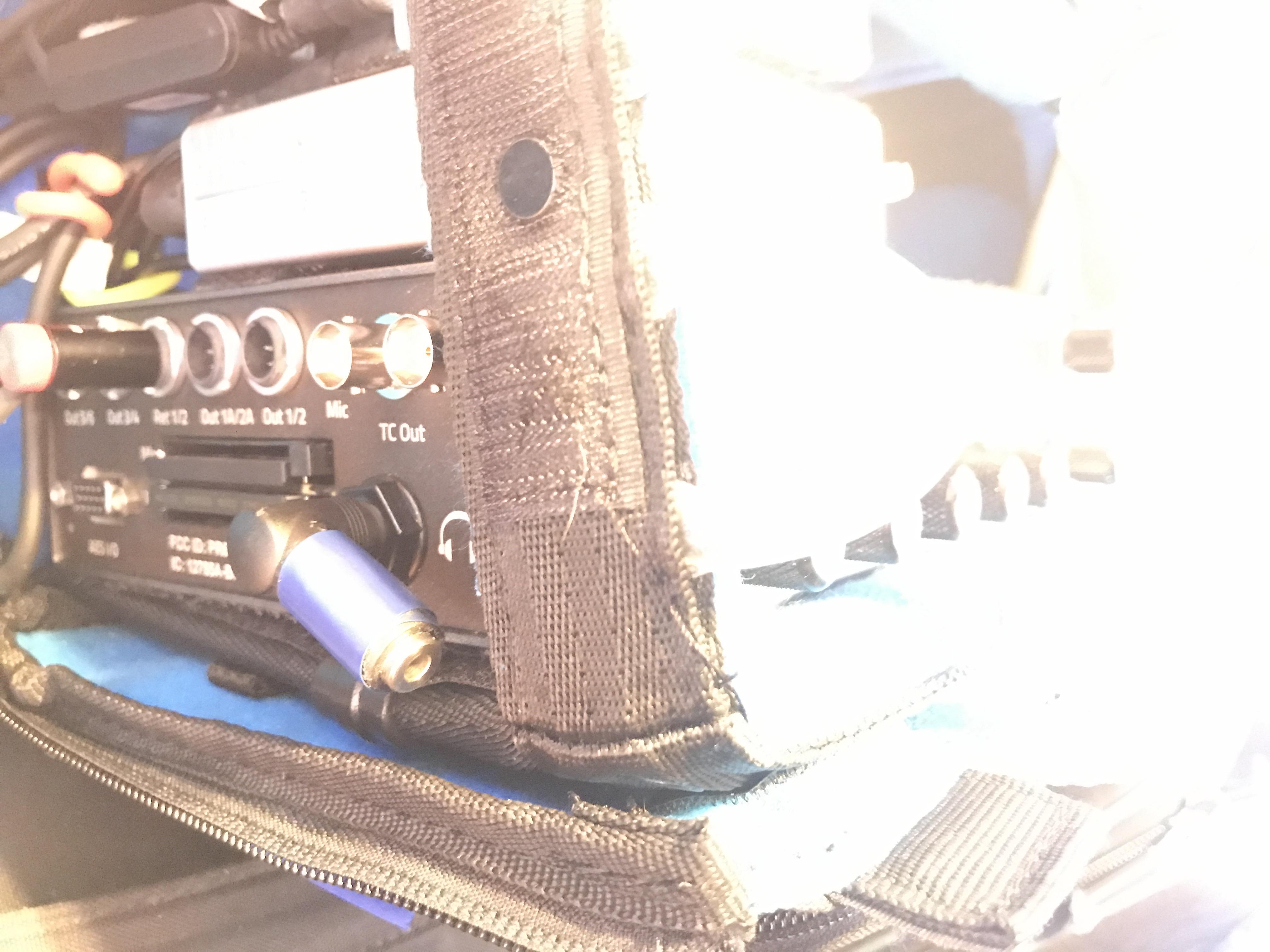

Kvark Posted October 22, 2019 Report Posted October 22, 2019 Really wish it had a 3.5 mm jack for headphones as well. Use the big one for normal work. If the jack breaks inside the socket you switch to the 3.5 mm instead and save the day. I've gotten rental gear (664) with one of two headphone outputs broken because of this. Two sockets. One professional and one consumer. The latter will save you when you have to buy an emergency headset in a rural town somewhere in Africa, and the only thing they got is a Casio or some shitty noname brand. That's redundancy. (Yes, I usually bring backup headphones with screw on connectors. Prepared for anything) Quote

Dominique greffard Posted October 22, 2019 Report Posted October 22, 2019 19 hours ago, Kvark said: Really wish it had a 3.5 mm jack for headphones as well. Use the big one for normal work. If the jack breaks inside the socket you switch to the 3.5 mm instead and save the day. I've gotten rental gear (664) with one of two headphone outputs broken because of this. Two sockets. One professional and one consumer. The latter will save you when you have to buy an emergency headset in a rural town somewhere in Africa, and the only thing they got is a Casio or some shitty noname brand. That's redundancy. (Yes, I usually bring backup headphones with screw on connectors. Prepared for anything) i tottally agree with that. My main headphone jack broke on my nomad years ago and the hp2 saved the day. I ll probably do a heaphone 1/4 to 1/8” jumper to protect the connector from tension. Quote
joepfeil Posted October 23, 2019 Report Posted October 23, 2019 I’m using a right angle 1/8 to 1/4” so I can keep the headphones at 1/8, which makes plugging into my erx/urx much quicker. Also protects. Quote
Peter Mega Posted October 23, 2019 Report Posted October 23, 2019 The Sound Devices XL-14 is what I use. I have a few which are permanently plugged into my recorder bag kits. I bring the 1/4 inch end up to the top of the bag for quick in/outs. never had a headphone jack issue Quote
osa Posted October 23, 2019 Report Posted October 23, 2019 16 hours ago, Dominique greffard said: i tottally agree with that. My main headphone jack broke on my nomad years ago and the hp2 saved the day. I ll probably do a heaphone 1/4 to 1/8” jumper to protect the connector from tension. +1 I also like being able to cable the headphone jack to the other side of the recorder and have external access Quote
