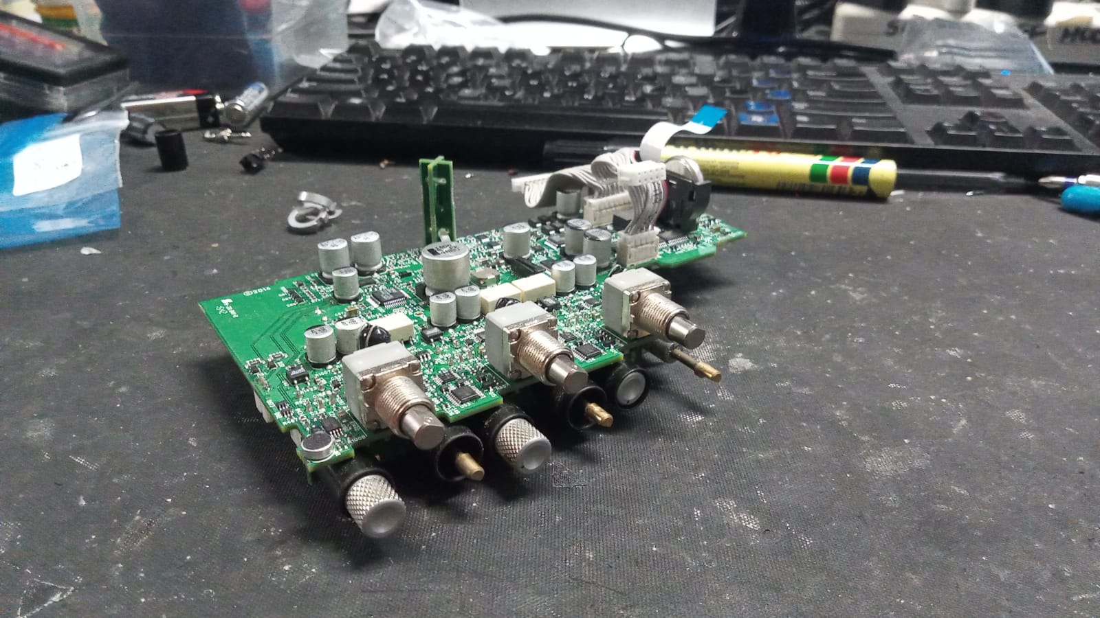

Conor Posted July 6, 2022 Report Posted July 6, 2022 You're probably going to need to send it in unfortunately. If the sand gets in too far then it needs to be disassembled. And you essentially have to tear down the entire machine to get inside to pot assembly. Here's a pic from the last time I had to do this procedure (albeit with a different pot). You can see how all of the pots have a very tightly fitted plastic cup around them to prevent matter from getting through to the PCB Quote
