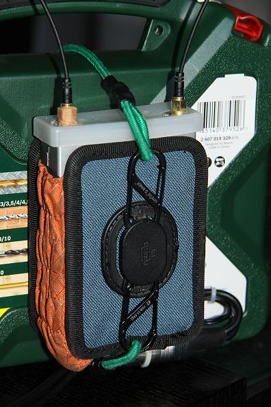

I use the small ones for attaching my Zaxcom RX900S in its Petrol pouch with a bungee to camera's
Would love to see a pic of that if possible Peter...
I have seen someone do something similar, but wasn't paying attention enough to remember how it was mounted.

Here's a pic of my Zaxcom RX900S in its Petrol pouch with bungee and S-Biners from Nite Ize. You can use any caribiner but the nice thing about the S-biner is that they are flat rather than round and they fit into the Petrol clip thingy without the fear of breaking it like when you use the round standard caribiner's. The S-biner is also easier to release the bungee.
The green and black boxes are simulating a camera body (sorry, I didn't have a DigiBeta or the like lying around the house for a proper photo!!)
The bungee goes around the camera body, under the handle and the whole things sits just behind the lens at the beginning of the camera body.
