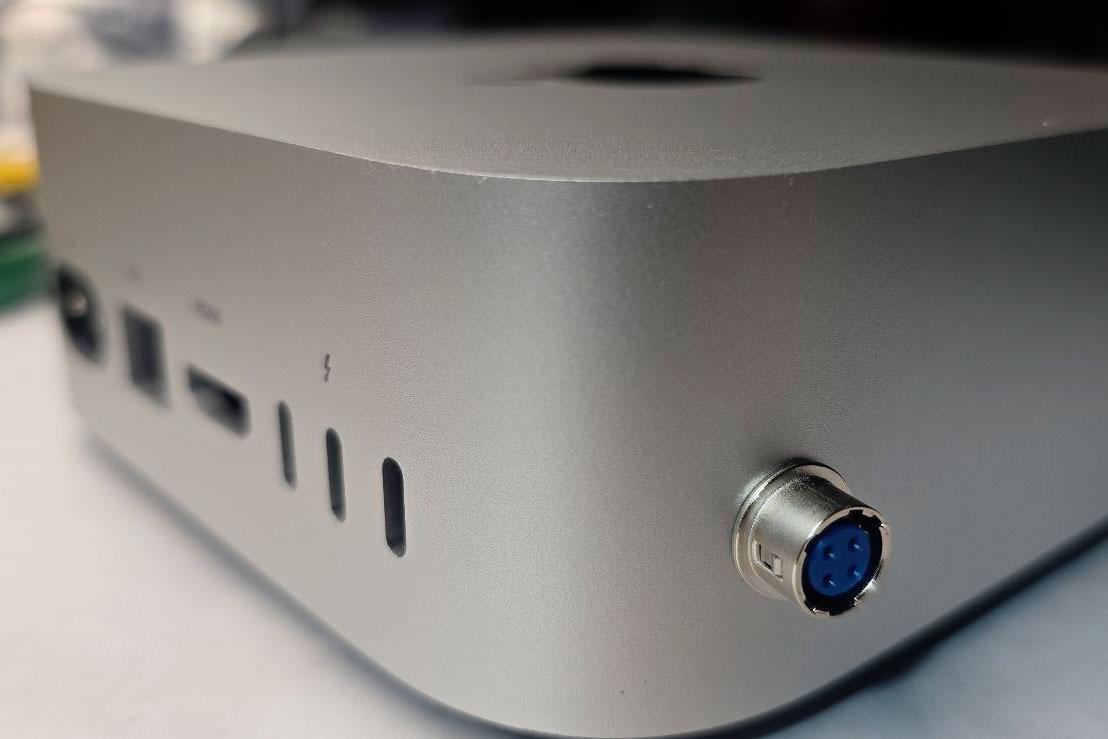

Doc Justice Posted May 7, 2025 Author Report Posted May 7, 2025 The baseline Mac mini with the M4 chip and 16 GB RAM is a powerhouse for WildTrax. It's on sale from Amazon for $495. Gotham Sound has just posted pictures on its first modification to run the Mac mini off of DC power, and there are a few YouTube tutorials to do it yourself. Even if you're not an everyday Mac user, the M4 is very compelling as a standalone recorder, no matter if it's your primary or backup. • M4 chip handles multichannel recording (more than capable of handling 512 tracks) and fast metadata writing with ease • 16 GB unified memory keeps everything responsive, even in large sessions • Thunderbolt 4 ports support fast SSDs and high channel-count interfaces • Compatible with Dante, AVB, and USB audio workflows • Silent operation makes it ideal for carts and studio environments • It measures 2" x 5" x 5" and weighs only 1.5 pounds Though I suppose this talk is more appropriate in the Recording Direct To Computer forum... Quote
