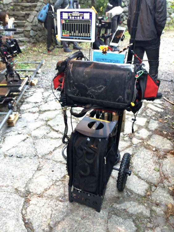

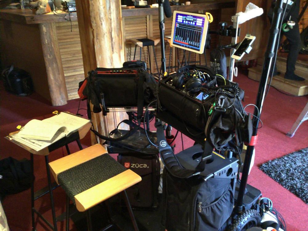

mikewest Posted December 15, 2016 Report Posted December 15, 2016 Right my recent efforts have prove so convenient! 664 stablised by elements from ORCA harness Pix attached mike Quote
Jeff Wexler Posted May 30, 2017 Report Posted May 30, 2017 Interesting. Looks a little top heavy when fully loaded. Also, and I don't mean this as a criticism, the actual ZUCA (bag) part of this cart seems to be the least significant part of the build --- supplies some storage and a base for wheels but that appears that's all it has to do. I have a ZUCA cart I purchased years ago and started to build a mini cart but never really pursued it because I was worried that everything else I would have to build onto the bag would make the ZUCA part pretty irrelevant. Quote

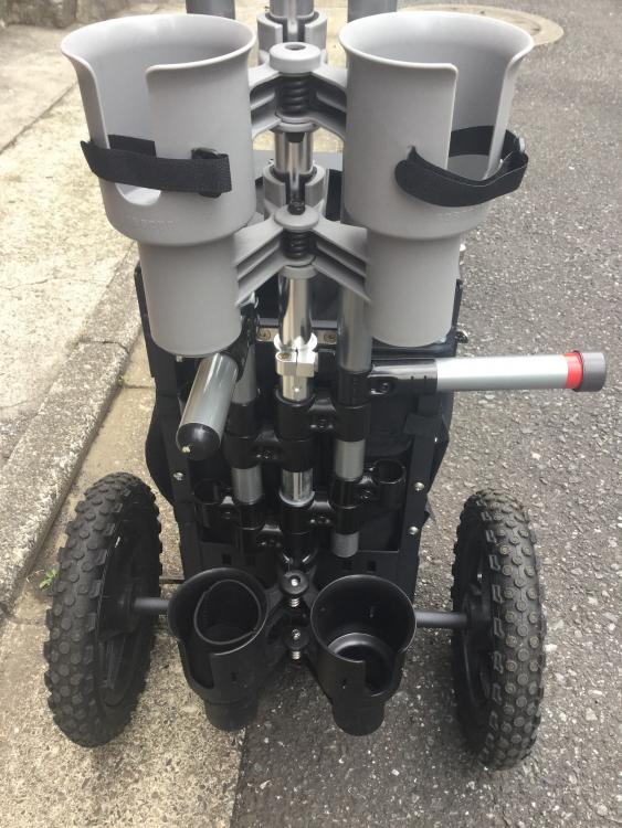

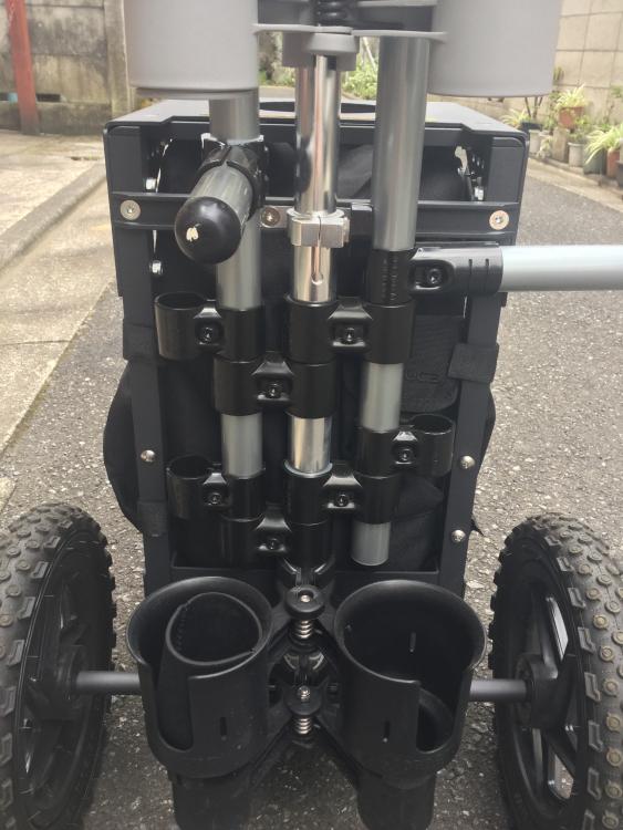

Bethann Posted March 7, 2021 Report Posted March 7, 2021 On 6/9/2017 at 3:57 AM, Takuro Kochi said: Boom Stand Quote
