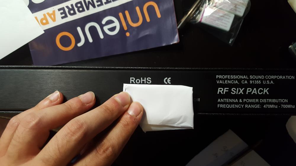

thope Posted September 21, 2017 Report Posted September 21, 2017 I just received my six pack, and the new version does not have the db37 connector on the bottom. The only audio outputs are the side ta3's. This is not reflected on the psc website . Quote
Mungo Posted September 21, 2017 Report Posted September 21, 2017 1 hour ago, thope said: I just received my six pack, and the new version does not have the db37 connector on the bottom. The only audio outputs are the side ta3's. This is not reflected on the psc website . I've got the new version too, and yes, the connector is missing. I didn't mind because I don't need it, but if this annoys you, write a mail to Ron Meyer saying that you had expected more. He seems very cooperative and understanding. Quote
thope Posted September 21, 2017 Report Posted September 21, 2017 I've done that through the supplier, it was a major pain for me, as I'd already had cables made up. The other problem was that the unit has been made wider, so it didn't fit in the bag that I had just had custom made! Quote

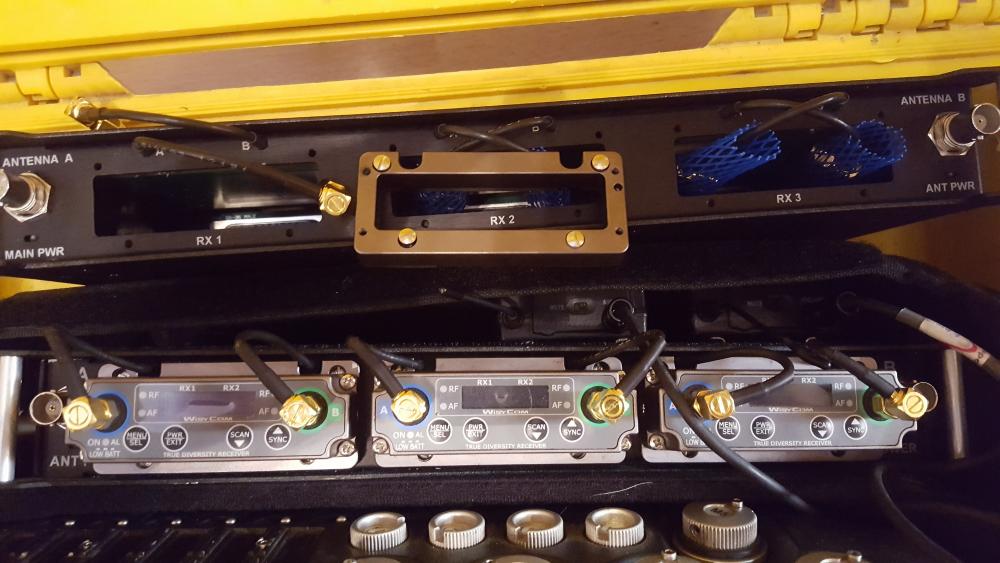

Audiolambda Posted September 21, 2017 Report Posted September 21, 2017 3 hours ago, thope said: I've done that through the supplier, it was a major pain for me, as I'd already had cables made up. The other problem was that the unit has been made wider, so it didn't fit in the bag that I had just had custom made! another issue is that the RF cables are at a shorter distance now so Wisycom PSC custom flanges can't be used anymore. We addressed the issue today to Wisycom as they were unaware of that. Check the picture: the old model is the one with the MCR42 receivers and the metal flanges are perfect for it while as you can see they can't be used with the new model. Quote
John Ronnerblad Posted September 21, 2017 Report Posted September 21, 2017 Would you mind show more photos to compare the old/new six pack. I would like to see all sides and underneath it as I havnt found any pictures of the new one. I have the old one attached with Tim Whites hinge mount to my X3. So screwholes must match to fit the new six pack. Quote
Audiolambda Posted September 21, 2017 Report Posted September 21, 2017 2 hours ago, John Ronnerblad said: Would you mind show more photos to compare the old/new six pack. I would like to see all sides and underneath it as I havnt found any pictures of the new one. I have the old one attached with Tim Whites hinge mount to my X3. So screwholes must match to fit the new six pack. you're welcome. No db37 door, size is 31,5cm (33,5 for the outer metal cover)x 12cm (14.5cm for the outer metal cover) x 4cm Quote
