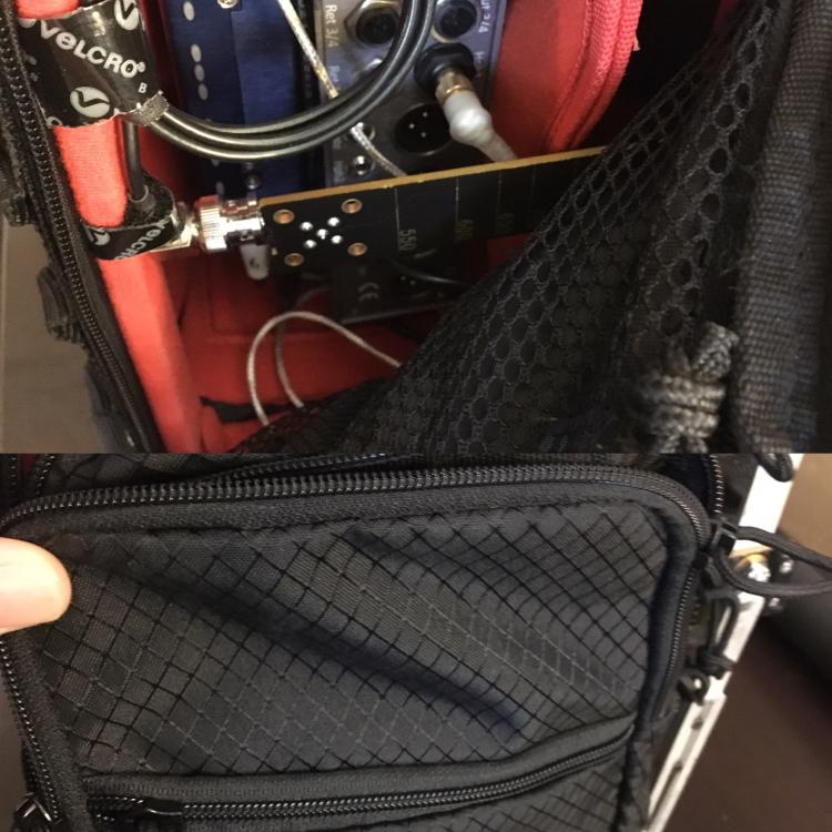

PTA Posted October 14, 2016 Report Posted October 14, 2016 On 10/11/2016 at 8:38 PM, GAGaudio said: How did you mount your dipoles? Can you show a picture inside the bag? Quote

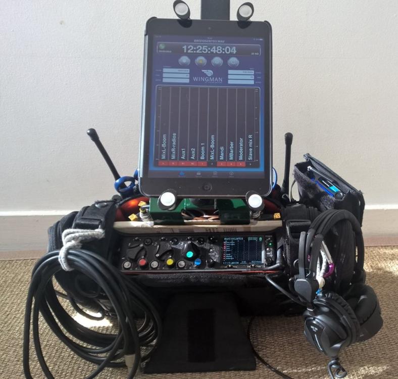

Soundwell Posted October 29, 2016 Report Posted October 29, 2016 My offering: SD633, Stingray Jr bag, AW DADM226, AW RX x4 + Wingman/iPad mini support rig Quote

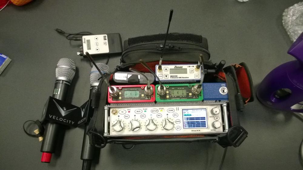

lyrnxG Posted October 29, 2016 Report Posted October 29, 2016 10 hours ago, Soundwell said: My offering: SD633, Stingray Jr bag, AW DADM226, AW RX x4 + Wingman/iPad mini support rig Soundwell, you are the first ive seen using the Audio Wireless Distro. How about a review?! Quote
Soundwell Posted October 31, 2016 Report Posted October 31, 2016 Hi, sorry for not getting back to you earlier - long days... have a look at these links: http://www.audiowireless.co.uk/products/diversity-antenna-distribution-module and the IPS video from IBC 2016 https://vimeopro.com/ipstv/ips-tv-at-ibc-2016/video/182199247 It's a very well made product that just works. Quote

GAGaudio Posted December 28, 2016 Report Posted December 28, 2016 Thought I would share my bag. Came across this tactical bag that is more compact & lighter then my ktek and fits my nomad perfectly. Very happy with this setup it's like having a porta brace/ktek hybrid Thought I would share my bag. Came across this tactical bag that is more compact & lighter then my ktek and fits my nomad perfectly. Very happy with this setup it's like having a porta brace/ktek hybrid Quote
Pete D Posted December 28, 2016 Report Posted December 28, 2016 Looks cool. What's the make/model? Do the sides of the bag open up so you can get to the card slot an whatnot? Quote
fieldmixer Posted December 28, 2016 Report Posted December 28, 2016 Looks cool. What's the make/model? Do the sides of the bag open up so you can get to the card slot an whatnot? Yes indeed. Good creative find there. Do tell. What is this bag? Quote
GAGaudio Posted December 28, 2016 Report Posted December 28, 2016 4 hours ago, fieldmixer said: Yes indeed. Good creative find there. Do tell. What is this bag? Yes it has separate side bags but I cut the fabric dividing the main compartment to the side pocket. it was actually very easy and the stitching is done very well on the bag so you don't have to sew it after cutting it. It also has a lot of different pockets on the top so even though it's smaller I actually can store more things into this bag. and it has a built-in waste strap so all I needed from my harness is my shoulder strap so the bags fits firm against me. They have discontinued this bag so it's getting harder to find there are other brands But this is the original brand the other ones do not seem to be built as durable. https://www.amazon.com/Maxpedition-0403-Sabercat-Versipack-Khaki/dp/B001DRNHY0 5 hours ago, Pete D said: Looks cool. What's the make/model? Do the sides of the bag open up so you can get to the card slot an whatnot? Trying to post a photo of the side pocket but I keep getting a loading error I'll try later. Quote

PTA Posted January 30, 2017 Report Posted January 30, 2017 On 12/28/2016 at 0:12 PM, GAGaudio said: Yes it has separate side bags but I cut the fabric dividing the main compartment to the side pocket. it was actually very easy and the stitching is done very well on the bag so you don't have to sew it after cutting it. It also has a lot of different pockets on the top so even though it's smaller I actually can store more things into this bag. and it has a built-in waste strap so all I needed from my harness is my shoulder strap so the bags fits firm against me. They have discontinued this bag so it's getting harder to find there are other brands But this is the original brand the other ones do not seem to be built as durable. https://www.amazon.com/Maxpedition-0403-Sabercat-Versipack-Khaki/dp/B001DRNHY0 Trying to post a photo of the side pocket but I keep getting a loading error I'll try later.Edit Edit, are there any plastic loops on the bottom for a harness clip or just the 2 on top? Quote
