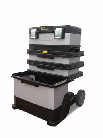

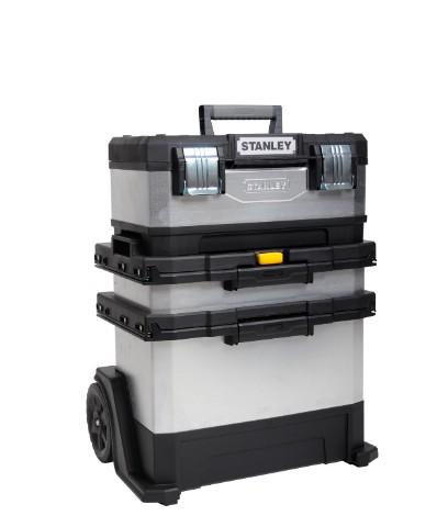

Nick Ray Harris Posted December 28, 2014 Report Posted December 28, 2014 Where can you get these Stanley drawers in the US? They only seem to be available in Europe. Quote
michaelmoote Posted May 13, 2015 Report Posted May 13, 2015 US only has two piece as far as I know. But was in Toronto visiting family and Canadian Tire was selling them (3 piece) , bought one and checked it as luggage. Quote

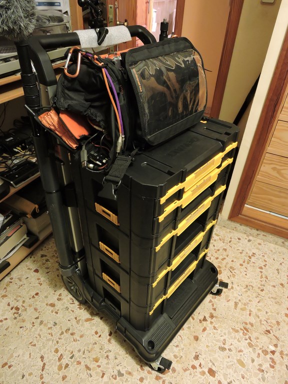

Jan McL Posted June 8, 2015 Report Posted June 8, 2015 Find myself on a project that will require more bag days than I've typically encountered. Spent some time with the DeWalt as a result. The drawer unit ever-so-sweetly snaps onto the top of the cart-mounted small, medium and large cases. Mini-cardellini clamp with Noga arm acts as place to hang cat5 cable for transport and will hold the monitor once landed. Added an AC strip and velcro for balun mounting. Bingo. Pudding proof forthcoming. Quote

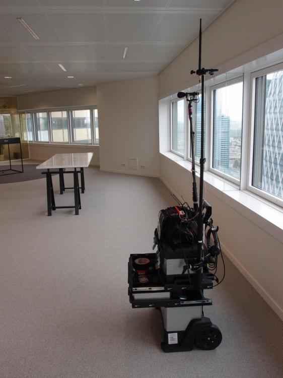

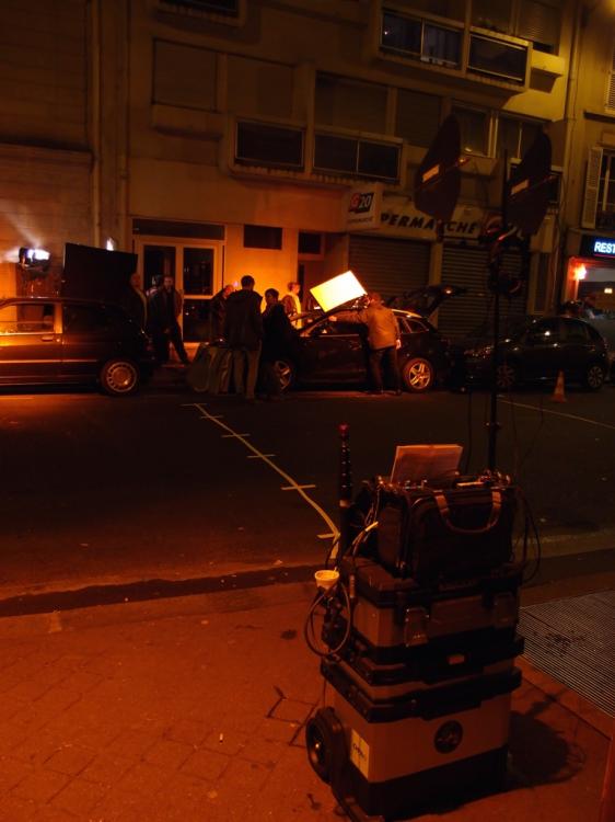

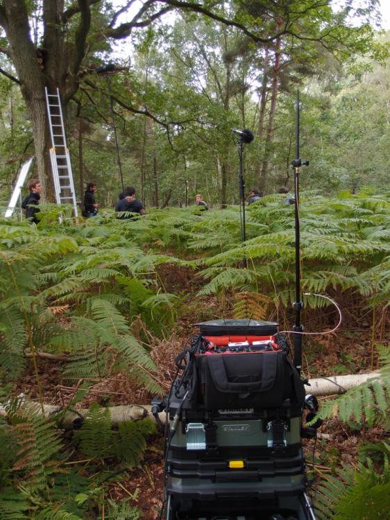

Bax Posted July 4, 2015 Report Posted July 4, 2015 (edited) Hi to all fellows of this topic ;-) I have checked this topic a will ago finding my self working to a very similar type of case (Stanley) ! In fact, the inspiring model for me has been the "Stanley Cantilever Fatmax" model. This model finally wasn't my final choice for two main reasons: 1: Not as hardened and secure as i wanted to be. 2: The cantilever opening system needs some "space" around the case to be fully opened... I finally choose the "Stanley Bi-Composite" case made of galvanized steel, aluminium and of coarse... plastic ! There are to types available apparently, with one or two drawers. I choose the one drawer for the more compact size and lightweight profile. I took the necessary time finalizing this project and had already the opportunity to do some field testing... Edited July 4, 2015 by Bax Quote
Bax Posted July 4, 2015 Report Posted July 4, 2015 The main modifications were: 1: Doing solid attachement of the top case to the main body 2: Attaching Manfrotto clamps to the sides of the top case with internal reinforcement 3: Changing the original "all plastic made" wheels with a far more solid (and handy) ones with flat free solid rubber tire. 4: Attaching Manfrotto cable or headphone holders 5: Attaching a dual boom holder système (Quickfist) Thanks for the inspiration to all and hope this will inspire others ;-) Some "in condition" photos : Quote

efksound Posted September 10, 2015 Report Posted September 10, 2015 Just got some on the Dewalt TStack modules and cart to replace my old Stanley workshop cart which has served me well for my one man gigs, but after 10 years of use it's time to find a replacement, Still considering keeping it or returning it, Like the toughness and quality of the drawers, but it's a lot heavier and believe or not can't put as many things inside :-) Quote
