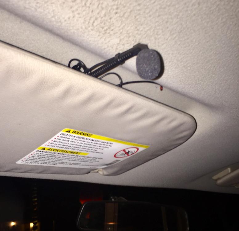

Jan McL Posted March 27, 2017 Report Posted March 27, 2017 On 3/26/2017 at 3:38 AM, roundbadge said: I have 2 4098's.when they work they're great.pretty good reach,like mini booms but seem too directional for some applications. I've semi burned myself a couple times on car shots when an actor moved to far of axis.or I placed it as a plant on a desk ,the actor stands up and it sounds fairly off mic.not very forgiving. definitely a pretty steep low roll off under 120hz. in a visor can be tricky to hide.not always head turn friendly.when something stealthy and omni is more appropriate I often switch to some visor 4060's,easpecially if there's more head movement Ive sent one back after the tube got broken off. I really REALLY wish DPA would make a full range wide cardioid version w/ shorter length. How are you placing the 4098's in the car? As you note, it's very directional. I'll add that too close provides a lamentable proximity effect. But the side lobe! Don't forget the side. In the placement pictured found that when the driver unexpectedly delivered a portion of his speech to the driver's side window, the passenger-side mic caught it from the window reflection. Admit this rig sounds like a car but they're in a car so... Quote
Philip Perkins Posted March 27, 2017 Report Posted March 27, 2017 Thanks! The mics are attached to the sunvisors or how? Quote
Jan McL Posted March 27, 2017 Report Posted March 27, 2017 5 hours ago, Philip Perkins said: Thanks! The mics are attached to the sunvisors or how? Visors. Yup. Quote

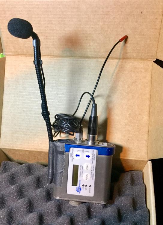

roundbadge Posted March 29, 2017 Report Posted March 29, 2017 Thanks Jan.I'll give that a go. here's some various 4098/4060's rigs that I've been using. Quote
