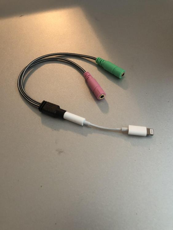

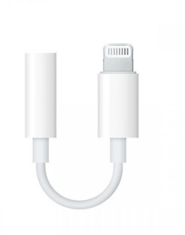

Csaba Major Posted June 6, 2020 Report Posted June 6, 2020 5 hours ago, JoshuaT said: The 8 series can send a mix via usb to iPhone Sadly it’s not a soultion for telephone calls. Iphone breaks the usb connection if you start a phone call. My solution is a minijack lighning Y cable, and sending a mic level mix from ProTools or a SD recorder. Quote
daniel Posted June 6, 2020 Report Posted June 6, 2020 1 hour ago, Csaba Major said: Sadly it’s not a soultion for telephone calls. Iphone breaks the usb connection if you start a phone call. My solution is a minijack lighning Y cable, and sending a mic level mix from ProTools or a SD recorder. Hi Csaba, Is the splitter shown – male end: 4pole; female ends: mono in / stereo out? Quote
NielsN Posted June 6, 2020 Report Posted June 6, 2020 3 hours ago, daniel said: Hi Csaba, Is the splitter shown – male end: 4pole; female ends: mono in / stereo out? It would have to be in order to work correctly. Quote
JoshuaT Posted June 6, 2020 Report Posted June 6, 2020 9 hours ago, Csaba Major said: Sadly it’s not a soultion for telephone calls. Iphone breaks the usb connection if you start a phone call. My solution is a minijack lighning Y cable, and sending a mic level mix from ProTools or a SD recorder. I have and use something very similar. It works great! Make sure you’re using mic level. Quote
