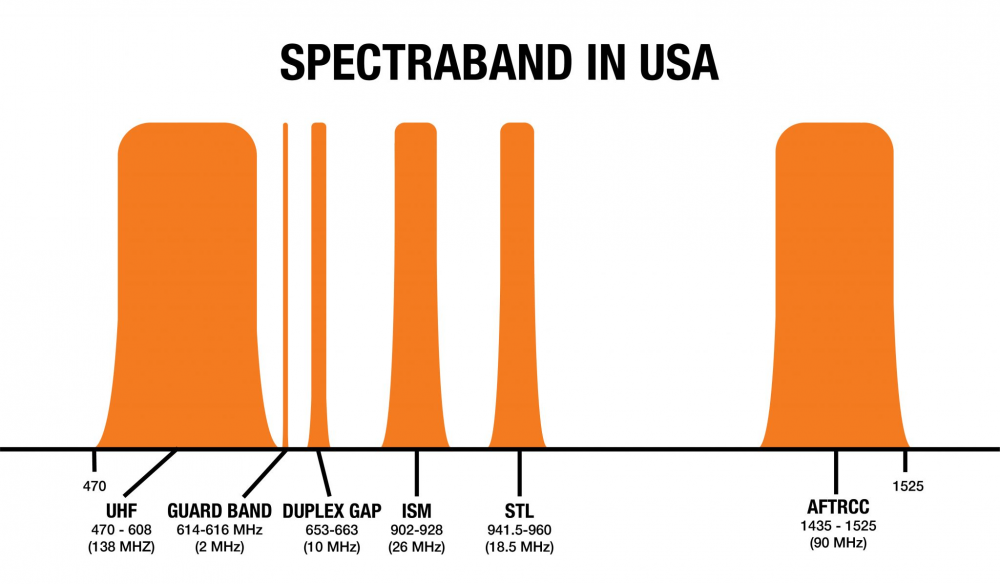

Michael Scrip Posted September 13, 2022 Report Posted September 13, 2022 What are your thoughts on the Sennheiser AVX system? It uses the 1.9 GHz band. I don't think there are many things that use that band. I've also seen some Shure mics that use the 900 MHz band. That frequency used to be for old cordless phones... but I don't think there are many things using that band either. Quote
IronFilm Posted September 14, 2022 Report Posted September 14, 2022 4 hours ago, Michael Scrip said: I've also seen some Shure mics that use the 900 MHz band. That frequency used to be for old cordless phones... but I don't think there are many things using that band either. Lectrosonics as well offers a few products using frequencies within the 900MHz band. (probably some other brands too, I think maybe Audio Ltd & Wisycom? ) Quote
Matthew Steel Posted September 14, 2022 Report Posted September 14, 2022 18 hours ago, Michael Scrip said: I've also seen some Shure mics that use the 900 MHz band. That frequency used to be for old cordless phones... but I don't think there are many things using that band either. Wireless microphone operators with a Part 74 license are allowed to use 941–960MHz, except for a few frequencies reserved for other uses. Some frequencies may be permitted only when coordinating with local FAA officials. Unlicensed use is not authorized, so any products in these bands are targeted toward professional users eligible for licensing. In contrast, I believe the old cordless phones operated on an unlicensed basis in the 900-928 MHz range. Quote
codyman Posted September 14, 2022 Report Posted September 14, 2022 2 minutes ago, Matthew Steel said: Wireless microphone operators with a Part 74 license are allowed to use 941–960MHz, except for a few frequencies reserved for other uses. Some frequencies may be permitted only when coordinating with local FAA officials. Unlicensed use is not authorized, so any products in these bands are targeted toward professional users eligible for licensing. In contrast, I believe the old cordless phones operated on an unlicensed basis in the 900-928 MHz range. Yeah you need a license fo rthe 941-960 stuff. Although the IST 902-928 stuff in the US is open season I believe. This is Sound Devices chart for their "spectraband" transmitter which seems to tune into anything and everything legal out there (in the US). Quote
