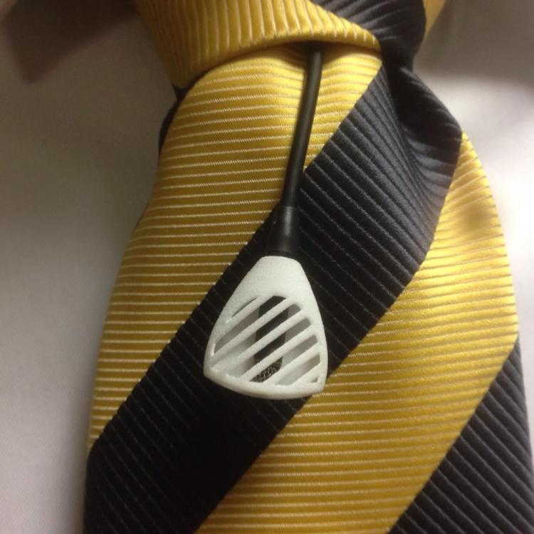

efksound Posted September 21, 2015 Report Posted September 21, 2015 (edited) Just discovered some new gadgets coming up for tie rigs http://www.hideamic.com/The website still seems in construction , but their facebook page works and has more pics and info Edited September 21, 2015 by efksound Quote

Toy Robot Posted September 21, 2015 Report Posted September 21, 2015 Just discovered some new gadgets coming up for tie rigs http://www.hideamic.com/The website seem seems still in construction , but their facebook page works and has more pics and info These look very interesting. I'm particularly interested in the fact that they have basically built a small cage around which the mic is suspended inside, like a mini blimp. This could be excellent for a lot of different things if it works the way my mind thinks it will. With some clever additions of Rycote overcover material or felt these could be really interesting. I'll definitely check these out, thank you! Quote
