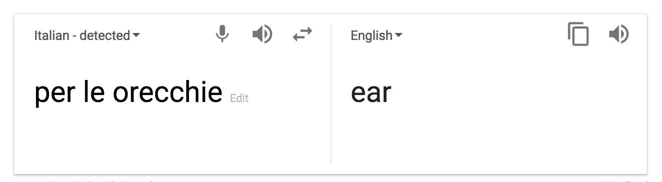

John Blankenship Posted May 3, 2017 Report Posted May 3, 2017 10 hours ago, Christian Spaeth said: I agree that 7 ms doesn't matter in relation to picture sync, but I have dialed in a few ms of delay on some inputs to compensate for differences in distance when mixing boom and lavs. For some wide shots it did help me achieve an appropriately sounding mix. per le orecchie Quote
Jim Rillie Posted May 3, 2017 Report Posted May 3, 2017 We all should really work by the ear as Mr Blankenship cleverly stated. Quote
