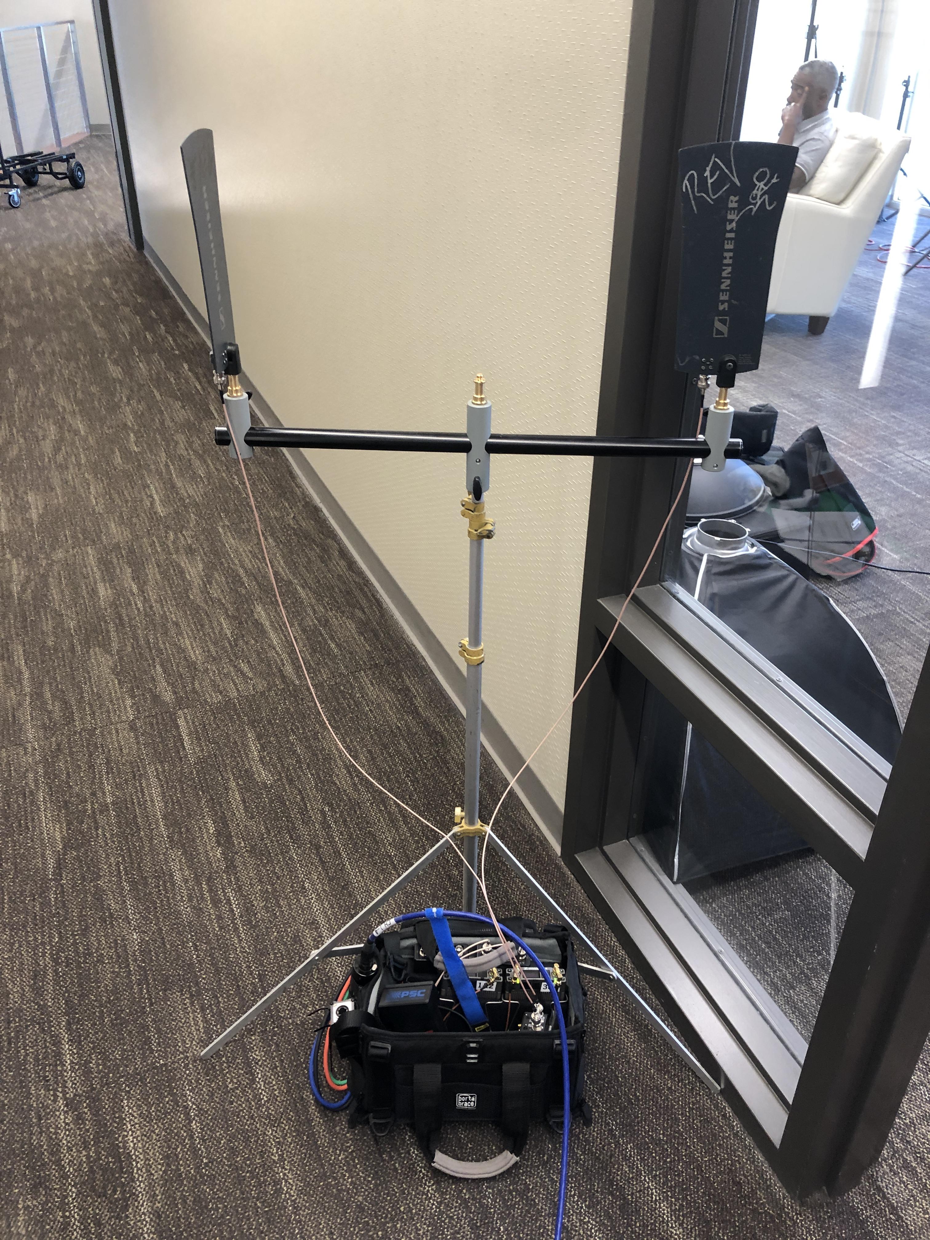

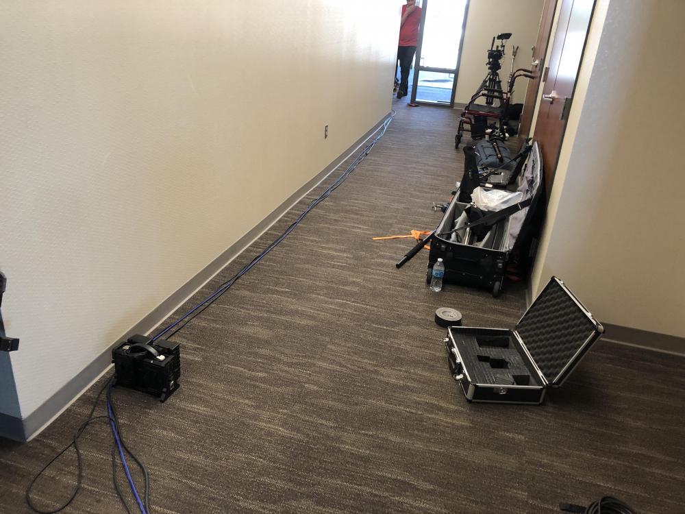

newzhack Posted June 22, 2020 Author Report Posted June 22, 2020 I worked my first shoot since March last Thursday and Friday. It was a little stressful setting up the bag and an antenna. I ran two Sennheiser 6042 receivers all day on two Lion NP-1 batteries. I set the bag up outside the rooms that were being used. I was able to set up about 50 feet away next to craft services. I ran the transmitters at 10 Milli watt because they were on 15 feet away and it worked great. I can say I am sold on the concept. After countless arrangements in the drop bag I finally decided to have another one for Comtek, boom return, and wireless hops to camera. It just got too crowded in the bag to try and do it all. I think these LYX pro are the best for the job and ended up being the cheapest. The ones with pigtails just seem to fill up the bag with excess cable. My receivers already have XLR connectors on my 5 pin outs. As far as cat 5 cable, I have ordered two more 50 foot "SoundTools SuperCAT". I like this cable over the others, it is a bit bigger but lays flat and is easy to lay out. The cheaper cable kinked up when I first unrolled it, I was a little concerned about it's integrity after that. It was also harder to coil. Both cables had to be carefully untwisted. I did it in the front yard with the sun shining and using pretty large loops the 100 foot cables were manageable. I am still trying to figure out how I am going to remote the feeds back to set (Comtek, etc.) but I will be working this way in the future if possible. I am still trying to figure out how to do this when I need to grab a bag and go. Quote

IronFilm Posted June 23, 2020 Report Posted June 23, 2020 5 hours ago, newzhack said: After countless arrangements in the drop bag I finally decided to have another one for Comtek, boom return, and wireless hops to camera. It just got too crowded in the bag to try and do it all. I think these LYX pro are the best for the job and ended up being the cheapest. The ones with pigtails just seem to fill up the bag with excess cable. My receivers already have XLR connectors on my 5 pin outs. As far as cat 5 cable, I have ordered two more 50 foot "SoundTools SuperCAT". I like this cable over the others, it is a bit bigger but lays flat and is easy to lay out. The cheaper cable kinked up when I first unrolled it, I was a little concerned about it's integrity after that. It was also harder to coil. Both cables had to be carefully untwisted. I did it in the front yard with the sun shining and using pretty large loops the 100 foot cables were manageable. I am still trying to figure out how I am going to remote the feeds back to set (Comtek, etc.) but I will be working this way in the future if possible. I am still trying to figure out how to do this when I need to grab a bag and go. Cheers for sharing your workflow! Been considering something like this for a project later this year I've got which needs remote recording on a couple of other locations simultaneously. https://www.lyxpro.com/products/lyxpro-4-channel-3-pin-xlr-multi-network-breakout-for-stage-recording-studio-xlr-male-and-female-to-rj45-ethercon That's a very affordable price! Any negatives to this? No impact on audio quality?? Would like to be able to send one or two channels of audio back up that same CAT cable, if you know of any easy/affordable solutions here. Interestingly, in the Amazon Q&A they say:"The boxes are passive so they will work in either direction. Male XLR to Male XLR should work great. " Sounds like it should work in reverse! Could you give it a try for us to send audio in both directions at once? Quote
