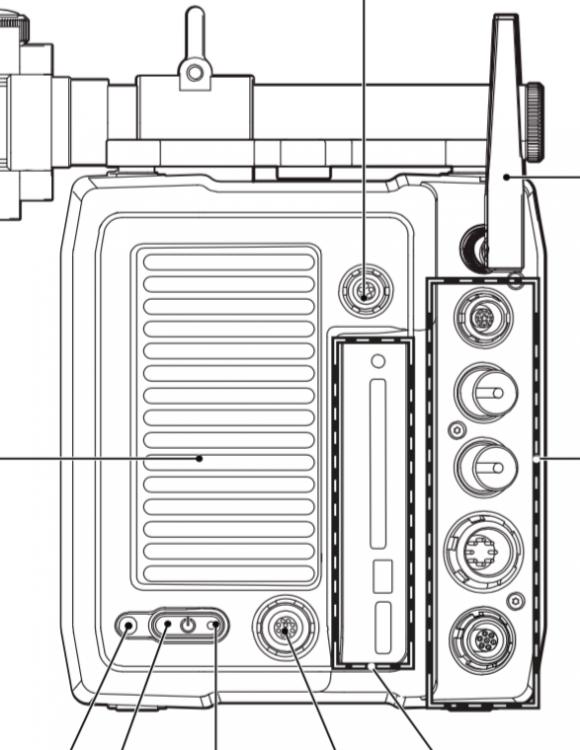

chrismedr Posted June 6, 2017 Report Posted June 6, 2017 11 hours ago, ninjafreddan said: In your experience with the Alexa Mini, which TC cable would be best to buy? Which angle would be the best? as mentioned above the only one that makes sense imo is if it goes left over the fan: but if it's not for gimbals or drones the camera dep will leave a gap to the batteries so that they can change cards easily, in which case just use a straight cable (or jam once and keep in free run) Quote
ninjafreddan Posted June 6, 2017 Report Posted June 6, 2017 4 hours ago, chrismedr said: but if it's not for gimbals or drones the camera dep will leave a gap to the batteries so that they can change cards easily, in which case just use a straight cable (or jam once and keep in free run) Okay, then I should be fine using a straight TC cable. Thanks for the information. :-) Cheers Frederick Quote
John Blankenship Posted June 6, 2017 Report Posted June 6, 2017 On more than one rigged Mini, I've found that the battery needs to be shoved up tight against a straight Lemo. In other words, a right angle version would be better and a bit quicker. Quote
