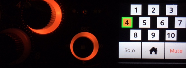

axel Posted December 14, 2017 Report Posted December 14, 2017 5 hours ago, DeJuan said: What about those two shortcut buttons that they made? There is a choice of 7 options you can dedicate the 2 shortcut buttons to. There is indeed an option where you can unite the icons of all 10 channels on the touchscreen along with a "solo" and a "mute" button. Tap on one channel icon and tap on "solo" to solo it. To go to the next solo you have to unselect "solo" for the first one, then tap on another channel and hit "solo" again. It needs the same amount of tapping/pressing like using the fader knobs to activate the channel setup screen whith its solo icon, only that the icons on the "solo" shortcut screen are smaller. maybe I also should mention that on the MixPre10 you can gang up to four inputs with one fader. Might be useful for ambisonics recording. and the TC section is 100% professional grade. There are just a "BNC in" and a "BNC out" plug instead of the usual Lemo5. Quote

IronFilm Posted December 23, 2017 Author Report Posted December 23, 2017 On 12/15/2017 at 4:24 AM, daniel said: Interesting what you say about the monitoring options. 1 of the reasons I stayed away from Zoom. I did not think any SD product would have a problem with this as they are already so experienced in making recorders, mixers etc. Things aren't so much fun if you can't isolate/select what you're hearing, when you need to. Sounds like the exact opposite, that it is easier to solo with a Zoom F4/F8 than with a MixPre10T Quote
