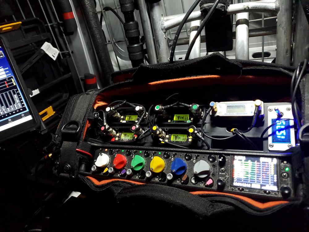

daniel Posted February 10, 2020 Report Posted February 10, 2020 Quite like the coloured faders - DIY or a source you can share? Quote
thenannymoh Posted February 10, 2020 Report Posted February 10, 2020 28 minutes ago, daniel said: Quite like the coloured faders - DIY or a source you can share? A guy named Simon in Montreal - pm me for contact info. He also does great receiver cages, coloured cables/caps etc Quote

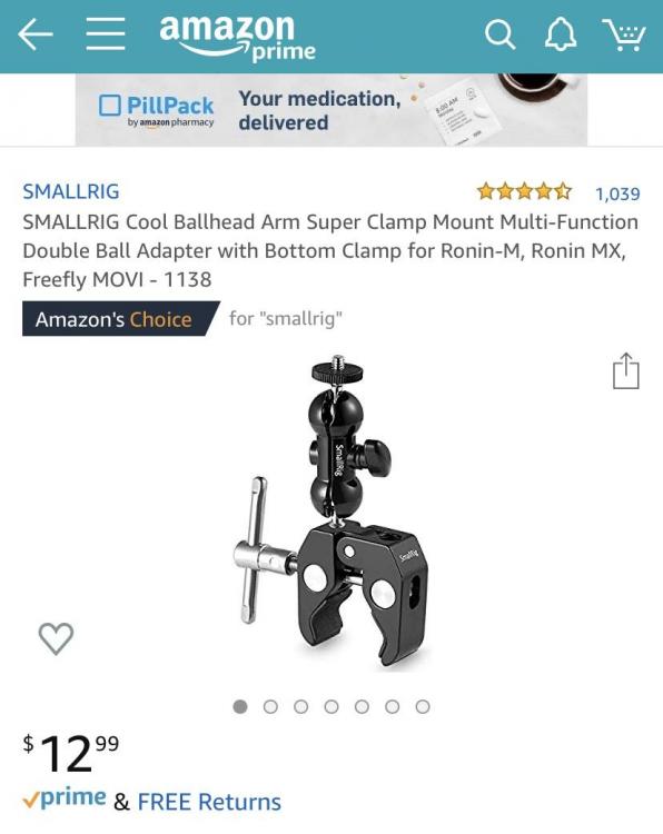

Mack Posted February 12, 2020 Report Posted February 12, 2020 Following. Can the SNA be modified to use the Betso bag adapter? Quote

frankaudio Posted March 16, 2020 Report Posted March 16, 2020 On 2/12/2020 at 11:16 AM, Mack said: Following. Can the SNA be modified to use the Betso bag adapter? Yes you need to get a 1/4 20 reducer the clamp and arm are all available on amazon from smallrig. I think I got the reducer from B&H 3/8 to 1/4-20 Quote
