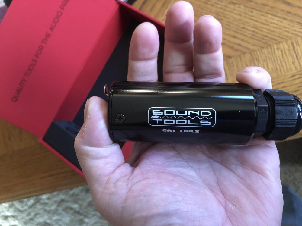

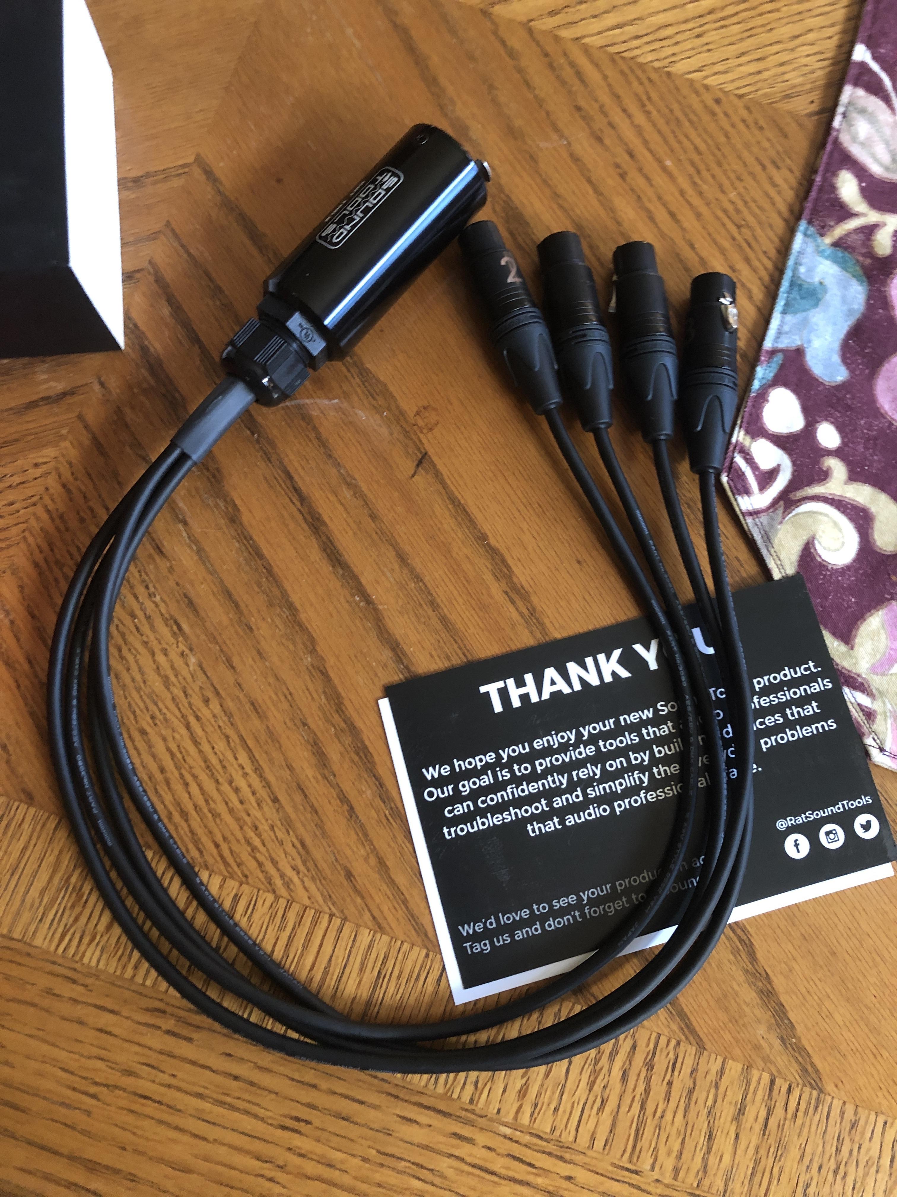

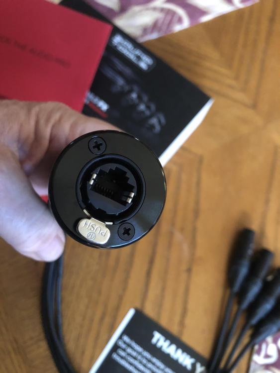

newzhack Posted May 18, 2020 Report Posted May 18, 2020 After finally seeing the advantage of a bag drop instead of an antenna drop I took the plunge Saturday. I ordered two Cat Tails from Sound Tools website, there is a male and female, on Saturday afternoon and it arrived Sunday evening. Their website link takes you to Amazon to complete the purchase. They are nicely packaged and look like a quality product. If this works out I will probably get another one so I can have 8 channels in my drop bag and use two of the channels to send Comtek and boom return back to the set drop bag with gender changers. They also sell a very hearty cat 5 cable. I have started with 100 feet, the cost works out to something under two dollars a foot. Quote
Jeff Wexler Posted May 18, 2020 Report Posted May 18, 2020 Thanks for posting the pictures --- looks like a much cleaner version of the InstaSnake from ETS. Over 10 years ago i discovered the InstaSnake line of XLR to CAT5 adapters, a really nice way to distribute analog signals over a single cable --- I don't think there wre any CatTails at that time.. I remember when I first got it I thought there must be a transformer like there is in the video baluns we had been using. Ran some frequency tests which were amazing --- no affect on the signal, wow! Turns out these devices are just a wiring scheme, no transformer or signal balancing, so no affect on the signal. Quote
