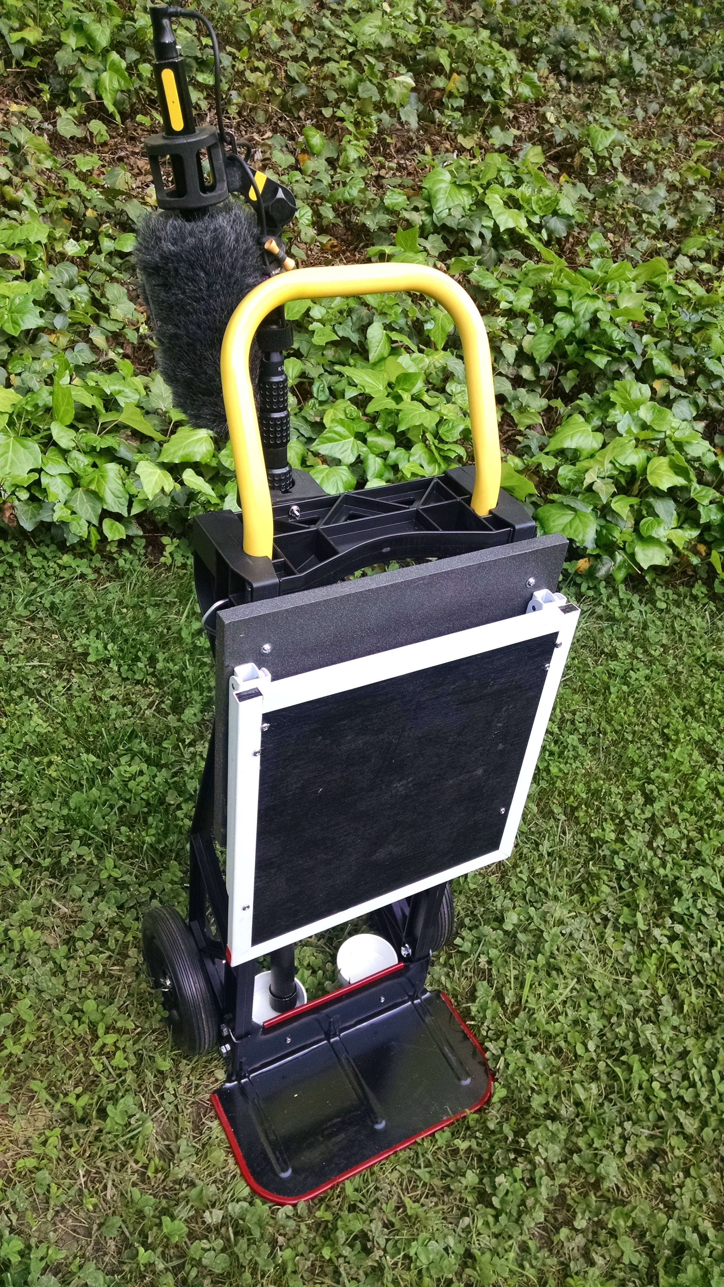

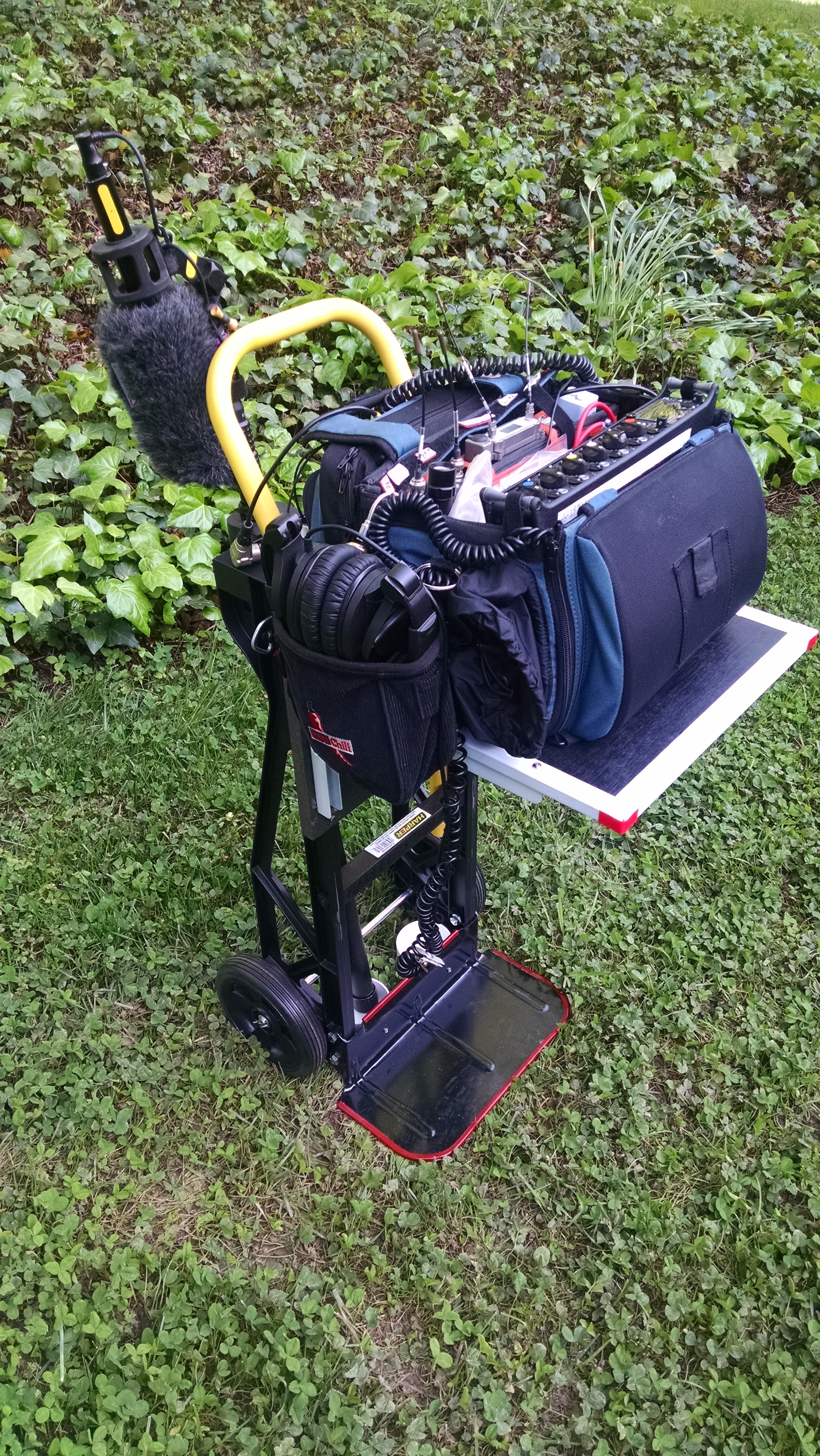

AlexQ Posted April 28, 2014 Report Posted April 28, 2014 Hey guys, I used this thread as a basis for how I would build my own bag cart. After browsing Home Depot, I came up with this. Heavy duty shelving brackets, nylon pegboard, steel frame handtruck, PVC and 5/16 hex bolts. I would like to extend the bottom lip and maybe add a second shelf. Also I had swapped out the solid neverflat tires with pneumatic ones. This thing feels rock solid. Quote

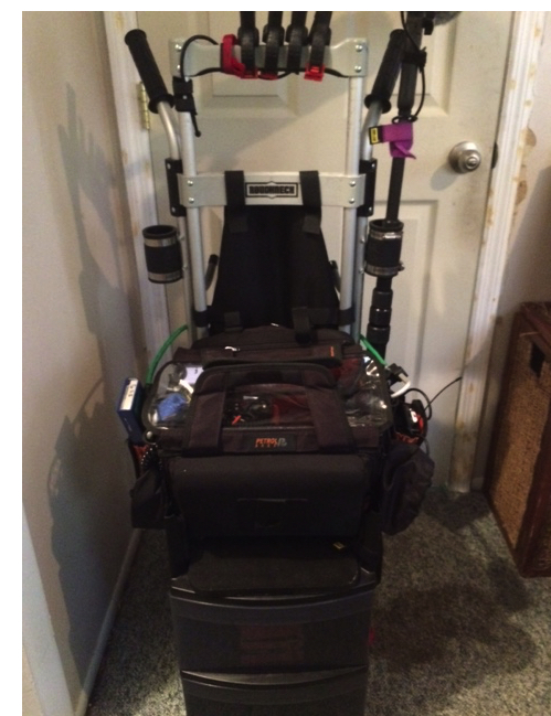

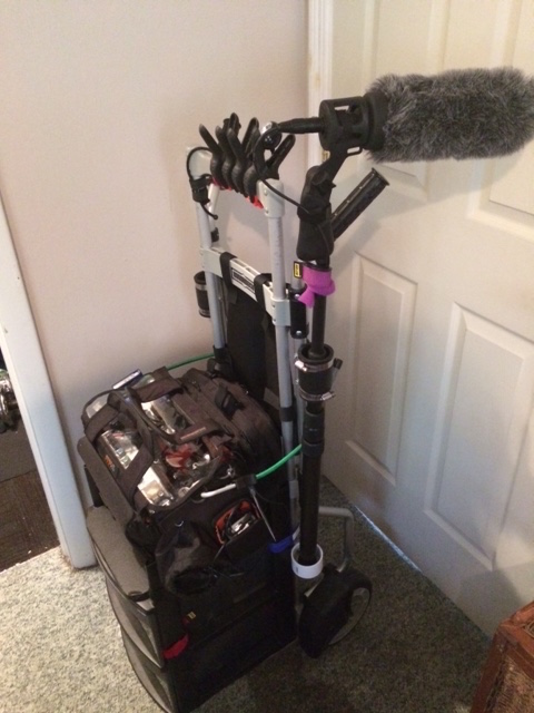

aginzo Posted January 8, 2015 Report Posted January 8, 2015 I know this thread hasn't been looked at since about April of last year but I thought I would add my little cart rig I made not too long ago. It's a simple Roughneck fold up hand truck I bought at Northern Tool for around $80. http://www.northerntool.com/shop/tools/product_200586484_200586484 Added some hooks from Home Depot to hold cables. Attached them in a way so that when it folds, the hooks fold flat on to the hand truck. Added some PVC base and a flexible PVC coupling for the top, all to hold a boom pole. Not completely happy with this and would like something more like a Toolflex holder if I could get a good place to get it here in Florida or online. One of the things I love the most about this setup is how compact it folds in my Ford Escape. leaves me so much more room to pack my gear bag, ditty bag, c-stand for a boom holder, another egg crate for misc. stuff and other odds and ends i bring to some jobs. Quote
Jeff Wexler Posted January 8, 2015 Report Posted January 8, 2015 I'm not sure why 2 of the photos are submitted side ways like that. They all should be the same orientation as the first one. Sorry for that. Maybe someone can tell me how to fix it here on JWsound. It happens usually because photos are taken with a smartphone in landscape orientation vs. portrait and this orientation is stored in the metadata of the image. It cannot be corrected once posted on JWSOUND but I usually fix it for our members when it happens by copying the photo to my computer, changing the orientation, saving it and then re-uploading it. Watch this space. Quote
aginzo Posted January 8, 2015 Report Posted January 8, 2015 It happens usually because photos are taken with a smartphone in landscape orientation vs. portrait and this orientation is stored in the metadata of the image. It cannot be corrected once posted on JWSOUND but I usually fix it for our members when it happens by copying the photo to my computer, changing the orientation, saving it and then re-uploading it. Watch this space. I tried changing the orientation on my computer and it uploaded the same exact way. No worries. Thanks. I normally only like shooting in landscape as a widescreen picture but I wanted people to see more of the length of it that I figured a portrait view could showcase better. Quote
aginzo Posted January 8, 2015 Report Posted January 8, 2015 It happens usually because photos are taken with a smartphone in landscape orientation vs. portrait and this orientation is stored in the metadata of the image. It cannot be corrected once posted on JWSOUND but I usually fix it for our members when it happens by copying the photo to my computer, changing the orientation, saving it and then re-uploading it. Watch this space. Thanks for the picture fix Jeff. Quote
aginzo Posted January 8, 2015 Report Posted January 8, 2015 I would love to get an idea how to make a foldable/collapsible shelf so it could fold with the cart. Quote
