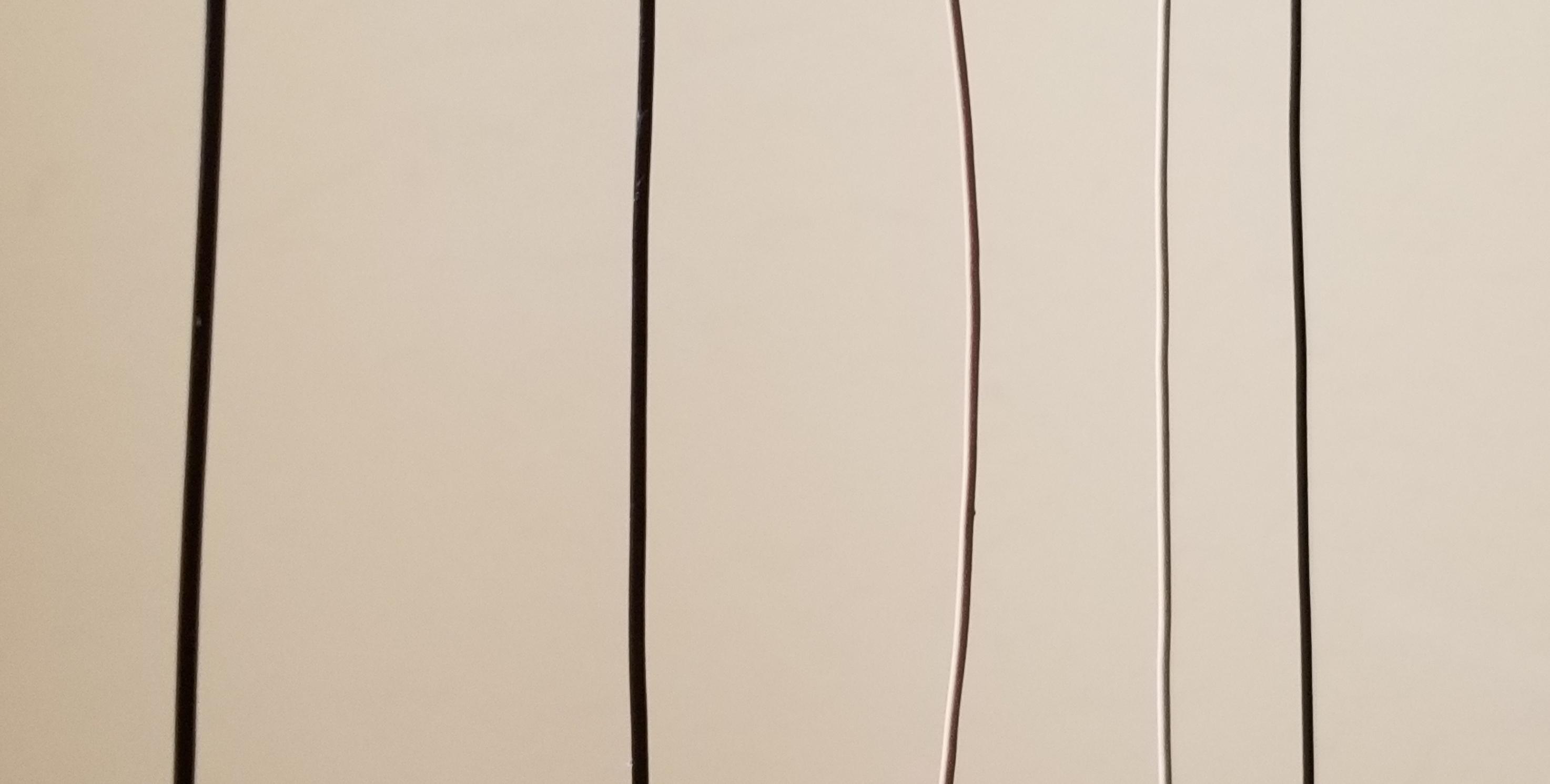

MartinTheMixer Posted October 20, 2018 Report Posted October 20, 2018 Hi all, ok, Here is a picture I took of 5 of my DPA 4063's. When I was cleaning them this morning I noticed that the beige one felt incredibly different, it feels as though it's thicker, it's much stiffer, and as you can see, more "curly" than the rest. I have them hanging up with about an inch of the wire and capsule above the hanging point. I also attached a AA cell to the microdot that is hanging down. I do this to "uncoil" them. Comments? Thank you, Martin Quote
Jan McL Posted October 20, 2018 Report Posted October 20, 2018 2 hours ago, jason porter said: Every DPA lav that I've ever owned has stiffened up to the point where I don't use them anymore. I've never cleaned them with anything other than my fingers (no solvents, etc) I've not used any solvent either but debate using water-wet cloth before longer storage in future because sweat (salt). Perhaps salt's the culprit. Quote
