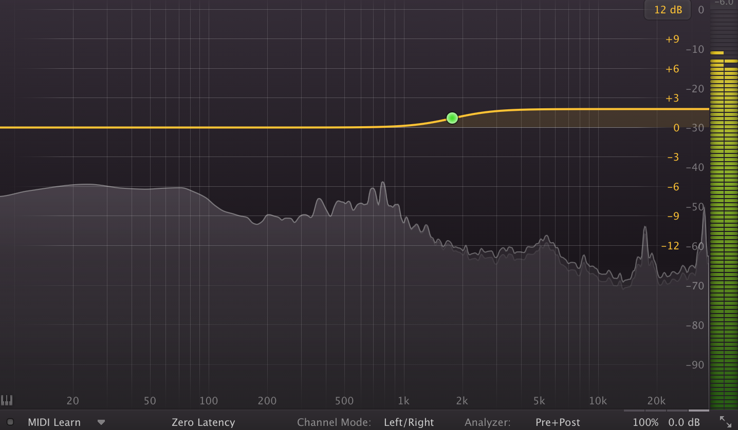

Benjamin Posted January 23, 2019 Report Posted January 23, 2019 I've picked up a unit and find it excellent. The mike pres/AD sound lovely, detailed and effortless. The DAC/Headphone amp is especially nice. I do have a few questions. The wifi operation is really convenient for my purposes: I throw the R4+ in a backpack, run 2ch mikes handheld and I'm off. I was chasing down some frogs through thick chaparral in So Cal the other night and loved having the unit fixed to by back. Am I right that it is not possible to adjust gain via the wifi web app? One other question: has any one noticed a low-level peak at ~17kHz? When recording at 96k, I notice another, possibly harmonic peak, at ~34kHz. I've attached a spectrogram to show what I'm talking about. The noise seems invariant between P48 and +20dB and +20dB with external P48 powering (though the levels are about 6dB lower). The peaks disappear when P48 and +20dB are disengaged and an external preamp is used. To be clear: I only noticed this when looking at the files in a sonogram. I can't hear it and I can notice no discernible degradation in the sound file. But it is there, so I want to check to see what might be going on, if only for the purposes of knowing the recorder better. I have an email out to Sonosax, but it's been a couple of month since I've heard back. Quote
Constantin Posted January 23, 2019 Report Posted January 23, 2019 1 hour ago, Benjamin said: I can't hear it and I can notice no discernible degradation in the sound file. But it is there You think you can’t hear it because it’s so quiet or because it’s so high? What happens when you pitch down? Quote
Benjamin Posted January 23, 2019 Report Posted January 23, 2019 2 minutes ago, Constantin said: You think you can’t hear it because it’s so quiet or because it’s so high? What happens when you pitch down? Because it's so high. I haven't pitched down yet, but will try that. Quiet is relative, of course, and these recordings captured the ambient noise inside my home with levels cranked up. On louder subjects, such as a recent capture of a stream, the levels of the subject are greater than the ~17kHz peak. I've yet to encounter a subject that exceeds the ~34kHz peak (though perhaps this summer I'll run into some crickets!). For reference, I'm attaching snippets of the recordings. There were captured within minutes of each other in my living room. sx0dBextpre.wav - R4+ with External Preamp, i.e. Line Level sx20dBextP48.wav - R4+ with External Phantom Box, i.e. internal mike Preamp with no phantom powering sx20dBP48.wav - R4+ with internal mike Preamp and phantom powering engaged sx0dBextpre.wav sx20dBextP48.wav sx20dBP48.wav Quote
Benjamin Posted January 23, 2019 Report Posted January 23, 2019 Per Constantin's suggestion, I've transposed the files using Logic and find a couple of interesting things: one, at -36 transposition more peaks appear, and; two, once audible, I hear what sounds like crickets. The curious thing is that the same "noise" shows up in recordings taken in my place in Portland, Oregon and at my relatives' place in Los Angeles, California and seems to disappear with an external preamp. Quote
Gordonmoore1 Posted January 23, 2019 Report Posted January 23, 2019 Just a thought - 17K is right about at the refresh rate for some monitors - I ran into this several years ago and found we could make it go away by turning off the monitors in the room. Quote
Benjamin Posted January 24, 2019 Report Posted January 24, 2019 16 hours ago, Gordonmoore1 said: Just a thought - 17K is right about at the refresh rate for some monitors - I ran into this several years ago and found we could make it go away by turning off the monitors in the room. Good suggestion and and I double checked to see if a monitor was the culprit. No such luck. The peaks are nonexistent when testing the recorder by itself with nothing connected. So I had thought that perhaps the issue was with my microphones or even cables, but I've used them with a number of other recorders and have never come across this issue. Quote
chrismedr Posted January 24, 2019 Report Posted January 24, 2019 hmm, what happens if you hook up a dynamic mic? Quote
Benjamin Posted January 27, 2019 Report Posted January 27, 2019 On 1/24/2019 at 11:20 AM, chrismedr said: hmm, what happens if you hook up a dynamic mic? I don't have one lying around, unfortunately. Quote
Constantin Posted January 27, 2019 Report Posted January 27, 2019 On 1/24/2019 at 5:19 PM, Benjamin said: The peaks are nonexistent when testing the recorder by itself with nothing connected. That demonstrates nothing. Something needs to be connected for any meaningful test Quote
Benjamin Posted January 28, 2019 Report Posted January 28, 2019 22 hours ago, Constantin said: That demonstrates nothing. Something needs to be connected for any meaningful test I had thought that it would rule out that the machine was self-oscillating at those frequencies. In any case, I'll reach out to Sonosax again. In the meantime, can any owner of an R4+ confirm whether their machine shows similar peaks? Quote
