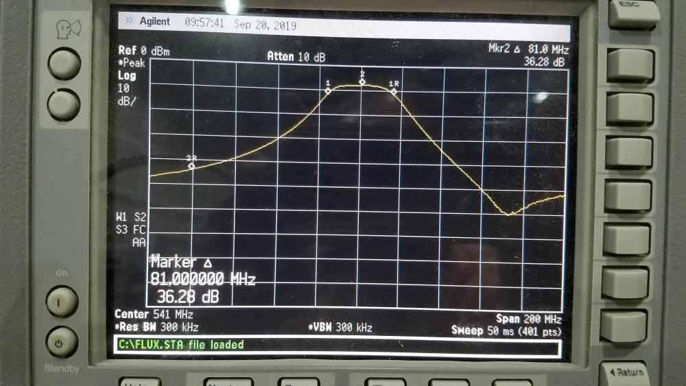

mano Posted September 19, 2019 Report Posted September 19, 2019 Does anyone know how the filters in the Nova / Micplexer compare to the ones in Audio Wireless's DADM226DT ? I find the DADM226's filtes are not too steep, even if the bandpass window is smaller than Zaxcoms (25 vs 35 MHz), I still find transmitters over 100Mhz away (reduced in RF power of course but still there) Thank you! Quote
glenn Posted September 20, 2019 Report Posted September 20, 2019 Here is a sweep of the filter in the Nova. It is 200MHz wide (20MHz per division) set at 541 MHz. It shows that signals at 460MHz are attenuated by 36dB. This is enough to totally eliminate interference by walkies. It would be nice to see what filters from other products look like. I do not believe that there are any filters out there that are as effective as the ones we use in our products. The sweep was obtained by connecting to the antenna of the Nova with the output coming from the RF output of the Nova. In terms of distance a walkie that would cause interference at 40 feet from the receiver would now need to be 1 foot from the receive antenna to cause the same interference. The big advantage to the Nova filter is that it can dynamically change to allow for frequency scans and receiver tuning and channel selection. Filtered antennas can not do this necessary function. Quote

mano Posted October 10, 2019 Report Posted October 10, 2019 On 9/20/2019 at 4:42 PM, glenn said: Here is a sweep of the filter in the Nova. It is 200MHz wide (20MHz per division) set at 541 MHz. It shows that signals at 460MHz are attenuated by 36dB. This is enough to totally eliminate interference by walkies. It would be nice to see what filters from other products look like. I do not believe that there are any filters out there that are as effective as the ones we use in our products. The sweep was obtained by connecting to the antenna of the Nova with the output coming from the RF output of the Nova. In terms of distance a walkie that would cause interference at 40 feet from the receiver would now need to be 1 foot from the receive antenna to cause the same interference. The big advantage to the Nova filter is that it can dynamically change to allow for frequency scans and receiver tuning and channel selection. Filtered antennas can not do this necessary function. Thanks, very interesting! I would love to see this too for other manufacturers. DADM226DT would be interesting, as it also has the feature of changing the filter band Quote
