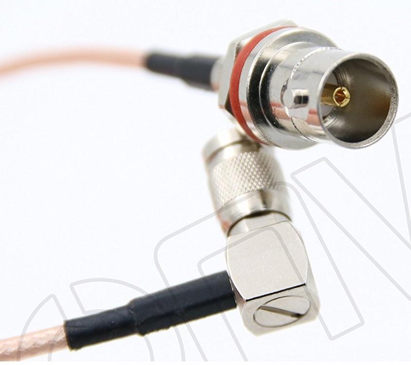

pindrop Posted August 30, 2017 Report Posted August 30, 2017 On 4/20/2017 at 2:58 PM, John Blankenship said: Someone must have convinced manufacturers that we have a burning desire to carry more and more specialty cables. I got some of these to ease compatibility with USO's and BNC cables I already have, they work well, and are relatively inexpensive. Nice right angle DIN connector too..... Eonvic BNC female bulkhead to Right angle 1.0/2.3 DIN male RG179 SDI cable jumper pigtail 20cm https://www.amazon.com/Eonvic-female-bulkhead-jumper-pigtail/dp/B01LYG69P5/ref=sr_1_1?ie=UTF8&qid=1504120181&sr=8-1&keywords=Eonvic+BNC+female+bulkhead+to+Right+angle+1.0%2F2.3+DIN+male+RG179+SDI+cable+jumper+pigtail+20cm Quote

Mobilemike Posted August 31, 2017 Report Posted August 31, 2017 4 hours ago, pindrop said: I got some of these to ease compatibility with USO's and BNC cables I already have, they work well, and are relatively inexpensive. Nice right angle DIN connector too..... Eonvic BNC female bulkhead to Right angle 1.0/2.3 DIN male RG179 SDI cable jumper pigtail 20cm https://www.amazon.com/Eonvic-female-bulkhead-jumper-pigtail/dp/B01LYG69P5/ref=sr_1_1?ie=UTF8&qid=1504120181&sr=8-1&keywords=Eonvic+BNC+female+bulkhead+to+Right+angle+1.0%2F2.3+DIN+male+RG179+SDI+cable+jumper+pigtail+20cm These look great, thanks for this! -Mike Quote

Constantin Posted August 31, 2017 Report Posted August 31, 2017 I think the UltraSync has a lot of impressive features. TC and Genlock on such a small box is incredible and a display is cool, too. But the DIN situation is a no-go for me. They way they stick out it looks very breakable and as was mentioned you either need a whole new bunch of cables or you get the cable mentioned above plus another one for the camera end, which negates the size issue to a degree. Now, I only had a brief look at one today, but how do you mount that thing? The surface looks and feels like it won't really hold any sticky tape so what are you doing there? the buttons also look flimsy and you can actually turn it on without physically touching a button. Just squeeze the whole case and it comes on. Fine, but what about turning off? It looks like it could inadvertently be turned off while mounted on the camera. Display is cool, but it looked like it's not sunlight-viewable. I also don't get the whole WAVE thing. So I buy this really small TC box, but to be able to fully use it I need this huge thing in my bag or on my cart. Although I also don't really get why we need this whole wireless autosync thing anyway. I'm more a set and forget kinda guy. And don't give me precision. All of these boxes will (or should) hold perfect TC for 24 hours. What more do I need? Sorry, this actually looked really interesting at first (Genlock), but there is just too much wrong with it Quote
pindrop Posted August 31, 2017 Report Posted August 31, 2017 15 hours ago, Constantin said: I think the UltraSync has a lot of impressive features. TC and Genlock on such a small box is incredible and a display is cool, too. But the DIN situation is a no-go for me. They way they stick out it looks very breakable and as was mentioned you either need a whole new bunch of cables or you get the cable mentioned above plus another one for the camera end, which negates the size issue to a degree. Now, I only had a brief look at one today, but how do you mount that thing? The surface looks and feels like it won't really hold any sticky tape so what are you doing there? the buttons also look flimsy and you can actually turn it on without physically touching a button. Just squeeze the whole case and it comes on. Fine, but what about turning off? It looks like it could inadvertently be turned off while mounted on the camera. Display is cool, but it looked like it's not sunlight-viewable. I also don't get the whole WAVE thing. So I buy this really small TC box, but to be able to fully use it I need this huge thing in my bag or on my cart. Although I also don't really get why we need this whole wireless autosync thing anyway. I'm more a set and forget kinda guy. And don't give me precision. All of these boxes will (or should) hold perfect TC for 24 hours. What more do I need? Sorry, this actually looked really interesting at first (Genlock), but there is just too much wrong with it Yes I wasn't sure about DIN connectors never having used them before, but now I have I like them and they seem robust, and are nice to use. I've got a whole load of cables for different cameras that have BNC male on one end so I simply got the low profile Eonvic, and it really doesn't add much at all. The only cable I've had made so far is DIN to right angle lemo (Anglissimo) for Alexa mini. to minimise cables. High tack self adhesive velcro just about works for attachment as the USO is so light, but there's going to be pouches soon. Apparently using a heat gun on the glue of self adhesive velcro makes it stick well, though I haven't tried this yet. (in TCS FAQ) It does not switch on completely if you squeeze the case, it appears to come on briefly, but shuts down again and needs an additional two quick presses on an arrow key to actually make it stay on, likewise for switching off. Any USO can be set as a master transmitter (mode - Master TX) so you don't need the whole Wave thing. I love wireless in addition to free run accuracy as within range (which is easily 100m) there can be no drift, no complicated tuning procedures required, which even with the best, they really needed to be tuned, for real confidence over a long day. If a USO goes out of range for a while it has the accuracy of any lockit style box, comes back in to range it re-slaves even tiny amounts of a frame. It works very well, especially with multiple cameras, and gives confidence, no wondering about, should we re-jam at any point in a long day? Many camera departments have developed a taste for very small sync boxes (even demand) Tentacles (but I didn't like them), and the Ultrasync delivers far more, in a box that's pretty much the same size and as lightweight. Quote

Philip Perkins Posted September 11, 2017 Report Posted September 11, 2017 Not jamming TC boxes is like breathing? Sorry, that just doesn't seem like enough of a deal to replace working gear. Small size is, but they need to get the connector thing more together to get me interested, that is a big deal. Skinny adapter cables with BNC females on the ends are accidents waiting to happen. For reference see RED cable 000-3.... Quote
thunderfm Posted September 11, 2017 Report Posted September 11, 2017 I've replaced tentaclesync units with the USO, so the plastic minijack socket was probably as much of a risk as the DIN connectors. I was using BNC adapter cables with the tentacles and they never let me down, however I understand that a dedicated cable is more reliable. As pindrop has said, the DIN connections feel very solid and I've not had any negative experiences with them as yet. As far as the breath of fresh air aspect goes, I only meant that it's one less thing to think about. I can just power it all up and in a few seconds it's all jammed and ready to go and will stay that way all day. Quote
